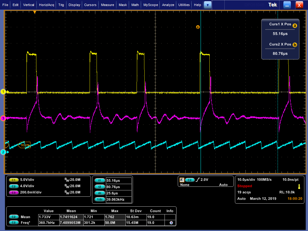

UC1846: Gate skipping operation of UC1846
Part Number: UC1846
I have a poorly designed flyback converter which operates with gate skipping at low loads. As per my understanding of the IC's operation, gate pulses should occur at even multiples of the oscillator/clock pulses. However, I see gate pulses at 3rd/5th distance from the first clock pulse. Is this a problem with the converter. If yes, please explain the IC internal function which lead to this mode of operation.
