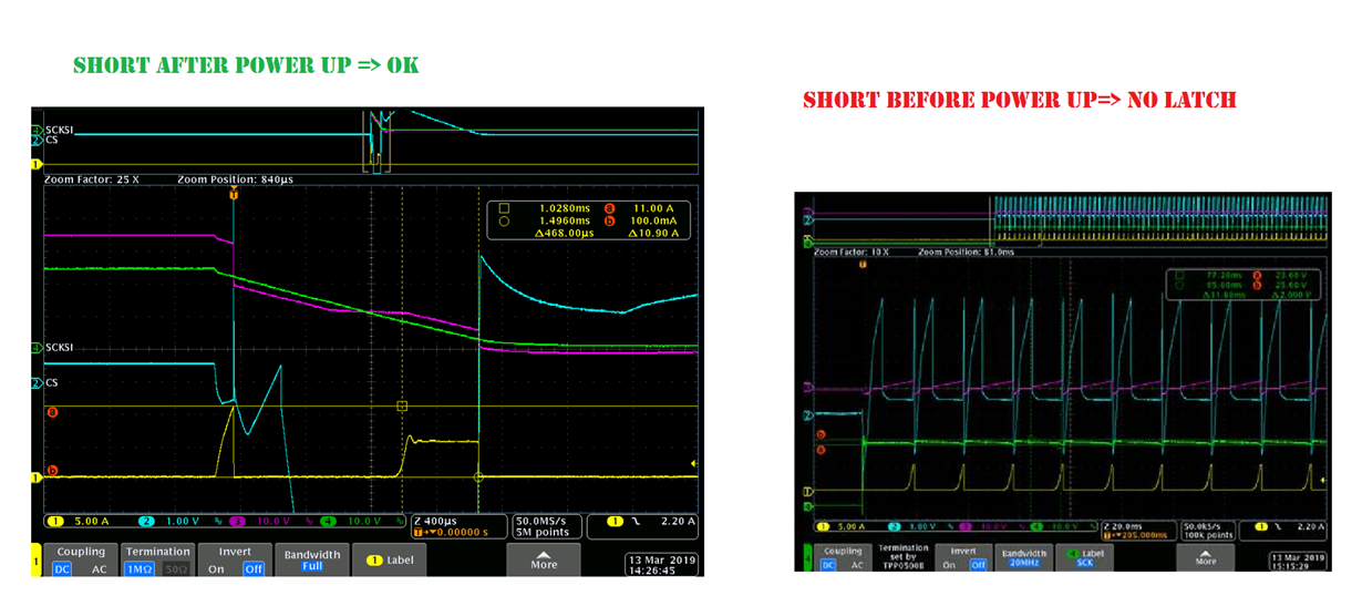

When we do the measurement of the short circuit before power on, we find the device cannot be latched off with LM5069MMX-1. is this normal behavior? any workaround to latch off?
When doing short circuit after power on, the device can be latched off the FET. It's ok as expected behavior.
Device: LM5069MMX-1 (Latch type)
 Application: Motor Drive
CH1: Input current
CH2: Timer pin voltage
CH3: Gate pin voltage
CH4: Input voltage
