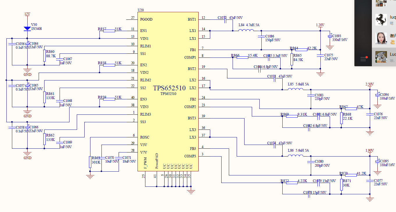

Dears:
Could you kindly help to check the below schematic?
Since the outputs are not normal ,and are little higher.
Hi, Sir
Some comments:
1. EN1, EN2, EN3 are low voltage pin(max 3.6V), you cannot connect it to VIN through 51kohm resistor.
Suggest to connect EN1/2/3 pin to V3V pin or external enable signal.
2. For Vout a little higher channel, does it work stable?
Could you send me the LX1, LX2, LX3 waveforms?
