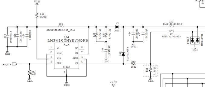

could you help measure PHASE MARGIN of LM3410YMYE and as below condition.
- Input: Voltage: 3.6V~4.2V
- Output: voltage: 13.25V

Hi Dexter,
I believe Issac has forwarded the answer to Roy Park for this. In general, the injection is point is into R59 of your schematic and using a signal analyzer the A input is the FB pin and the B input is the right side of R59.
