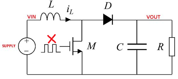

Hi TI team,
I was experimenting with few Boost controller and created a test condition where I stutdown the controller i.e the controller stopped switching. In this case, it turns off the MOSFET M. Voltage at VOUT node comes down to VIN. Hence, constant (VIN/R) DC current flows from the supply through inductor/diode. This current in turn loads the supply in shut down state as well. Is this expected that VIN will be loaded in shutdown state also? Please correct me if I am wrong.

    Yes this a feature of the boost topology, the load is always connected to the input by a DC path through the boost inductor and diode.
    If the PWM drive to the boost FET is disable and boost mosfet is held off only the boost function is disabled.
