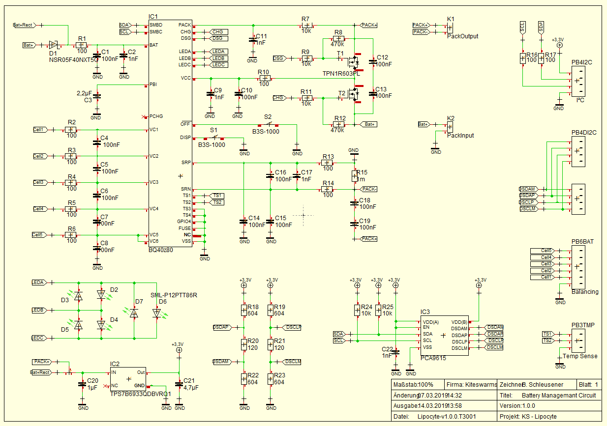

c) We are right now using the schematic that is found in the datasheet that you offer to show our job students how a schematic should definitely not look like. Maybe you might want to clean this up before you officially release the chip. Nicer version of the schematic is attached as example of how it could look like.
