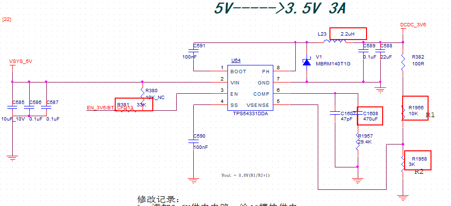

     problem: what may be the cause of the abnormal operation of the TPS54331 circuit under  the -40 degree cold environment test?
     circuit :
ph  picture:
discription
Device in the low temperature test chamber, when the temperature set to to 40 ℃, the device is powered on, one board can normal work, another board  is not normal.Input 5V is ok. There is no problem with other circuits except TPS54335,The output is connected to 4G module, and  TPS54331supports -40 degrees for industrial level.Other resistance and capacitance components are also industrial grade.
The two board have been tested twice. For the first time, only one board  has output, and for the second one, two boards cannot work.Remove the device, leave it at room temperature for a period of time, and return to low temperature test ,  both are normal after power on.
    What is the abnormal phenomenon ? And what is the load?
    From the schematic, C1608=470uF is too large, the system could be unstable, please change it to 1nF.
    And it would be better to change C588 to 2*47uF ceramic cap.
