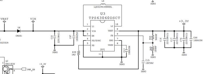

could you help measure PHASE MARGIN of TPS63060DSCT as below condition.
- Input: Voltage: 3.6V~4.2V
- Output: voltage: 3.3V
- Current: 200mA~300mA

Hi Dexter,
These are the phase margin measurement results:
Vin [V] |
Iout [mA] |
fc [kHz] |
PM [°] |
3.6 |
200 |
18.6 |
44 |
3.6 |
300 |
19.4 |
38 |
4.2 |
200 |
18.1 |
49 |
4.2 |
300 |
20.4 |
40 |
The results may be slightly different for your circuit, due to different capacitance tolerance and voltage derating.
With PM around 40° you might see a few oscillations (initial + 1-2 bumps) in the load transient response, but this is normal. If you want to improve the phase margin, refer to this application note:
http://www.ti.com/lit/an/slva289b/slva289b.pdf
