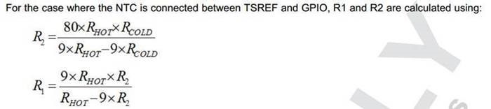

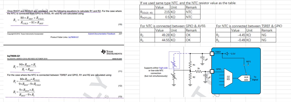

As the Pic, which show in the BQ79606 datasheet page238:
As you know, the NTC resistor will decrease during temperature increase. It means RHOT is less than RCOLD.
Based on this, R2 is negative value and can't calculate the R1. Please recheck it.

Hi Caesar,
If the NTC is connected between GPIO and AVSS, then RHOT will be less than RCOLD as you said.
If the NTC is connected between TSREF and GPIO, then the story is opposite.
Please be aware that the above equation is based on NTC connected between TSREF and GPIO.
Andy
Hi Caesar,
I do understand your question.
If the NTC is connected between TSREF and GPIO, then the story is opposite. Right?
I would suggest that we have to modify the DS, switching RHOT and RCLOD in R2 equation.
Andy
