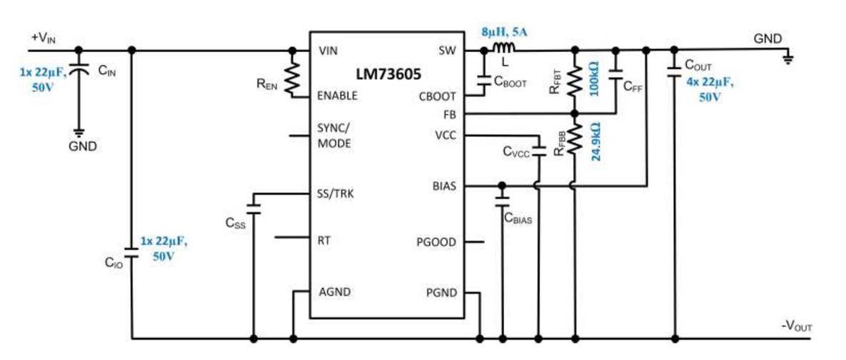

Hi Team,
My customer is seeking for solution to realize, 12V input and -5V output with 3A load ability. I recommended our LM73605 to working as buck-boost inverter to realize this. I use our TINA to simulated and would you pls help check if my below schematic works for this requirement? Thanks a lot!
LM73605 12V to -5V.TSC
Below is the schematic that I recommend customer to use, inductor is different with TINA simulation file:
From the simulation, the function is ok, can you help double check the schematic. BTW, if customer want to use the Enable and PGOOD, any suggestions or useful guidance for this case, thanks a lot!
