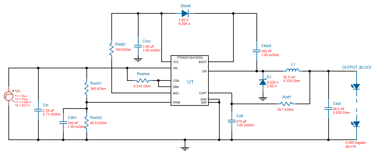

TPS92515 data sheet states Absolute Macimum Rating for PWM pin -0.3 to 5.5 V. Webench produces a design that conflicts with this requirement as shown in picture below.
At 48.5 V in and Ruvlo1 365 K and Ruvlo2 87 K, the voltage on the pin is approx. 9.3 V. With the given value on Ruvlo1 and Ruvlo2, was Ruvlo1 supposed to be connected to VCC instead?
