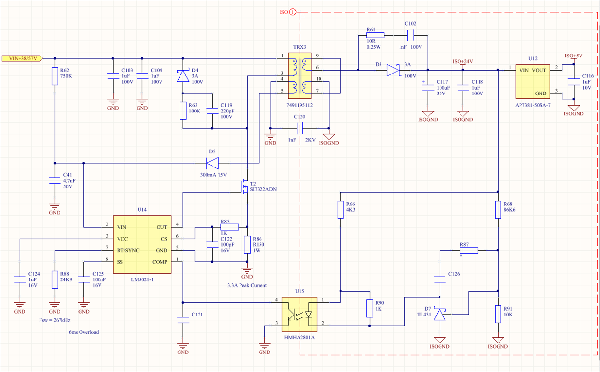

This is my first time designing an isolated power supply. I have the following specifications :
Vin : 38 to 57V
Vout : 24V 30W
Here is my schematic and captures of a few signals.
When no load on output (or a few mA), it goes to 24V. But when I put a load, even 100mA, it doesn't start and keep rebooting.
I've tried to simplify the design by strapping (R63, C119), remove (R61, C102, D5) and put 5k at R62 to force Vin (using internal zener for regulation), CSS tested with 10nF (current captures), 100nF, 1uF. Doesn't change a thing !
The LM5021 is working fine. But I really don't understand how it could do more than 100ns MOS ON time... It's obviously a BIG short circuit when the MOS is turned on...
Could you please help me to understand what's going on ?
Thank you for your time !
Michaël

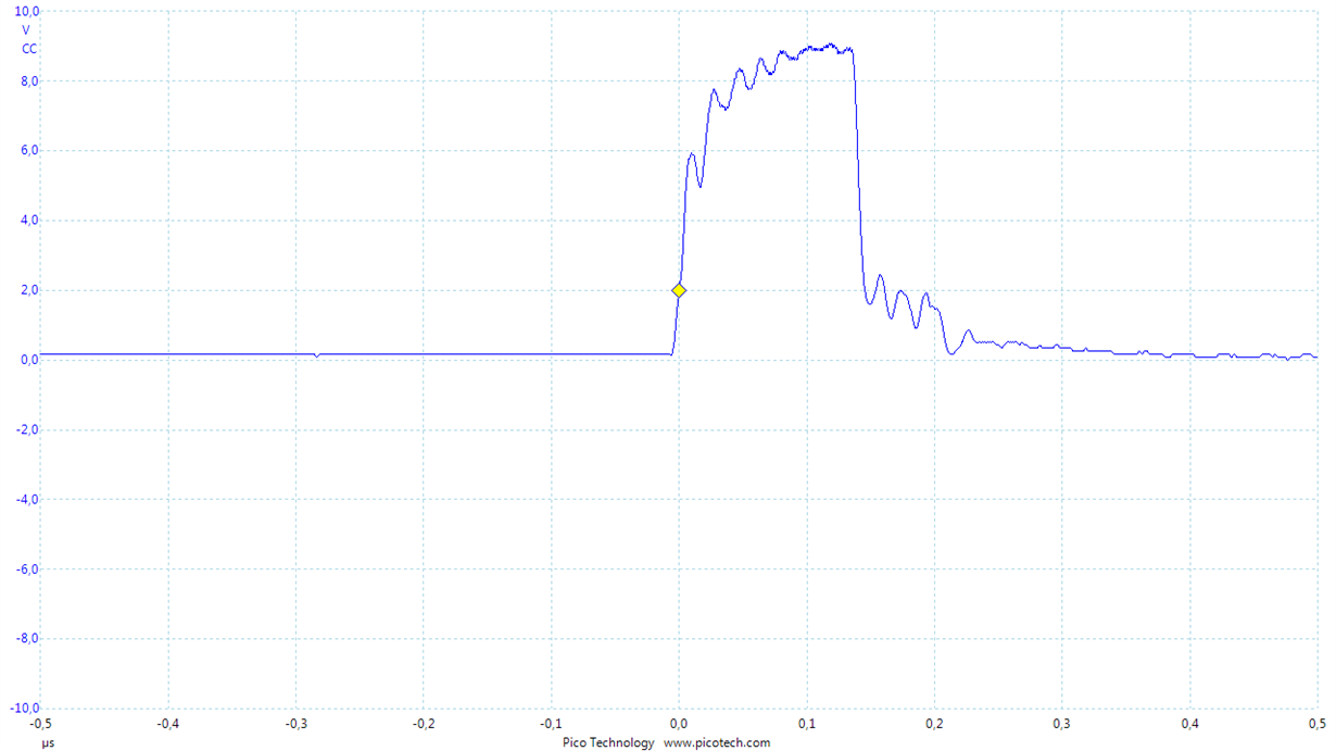

MOS Gate

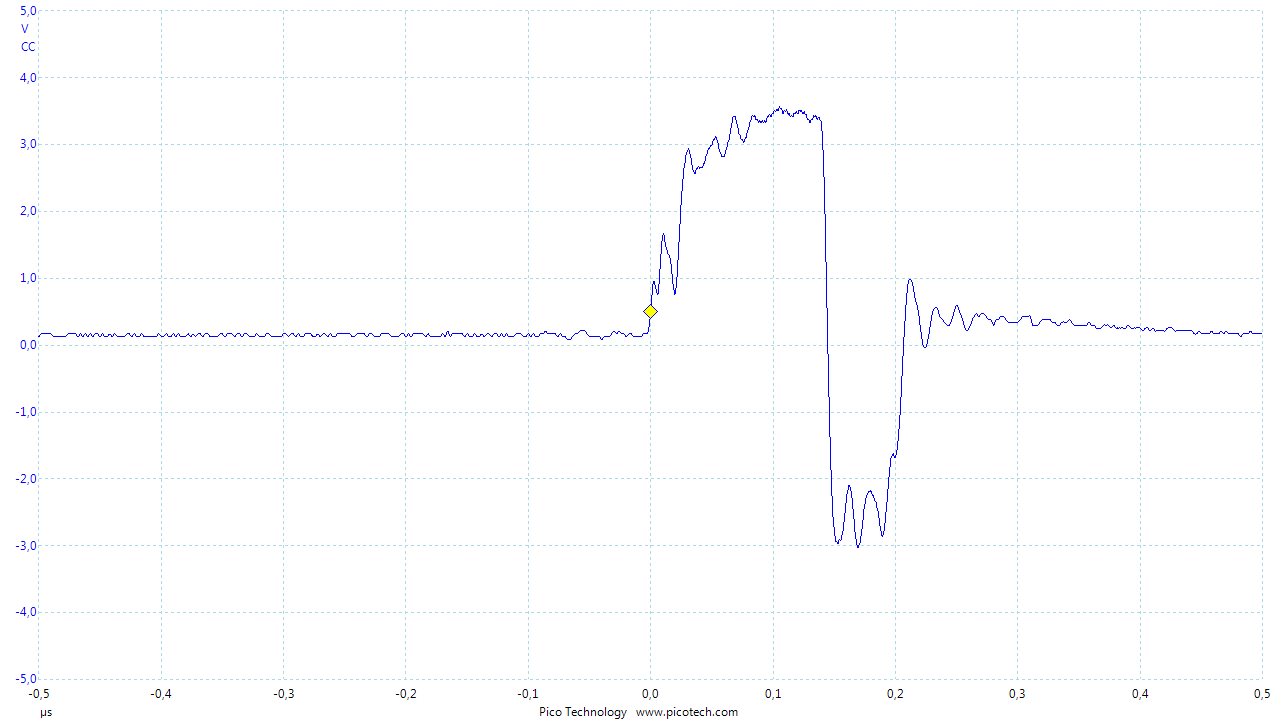

R86 voltage : Obviously it goes well over 0.5V and explains why the LM5021 stops the MOS conduction. Problem is, I really don't understand how it could be different...

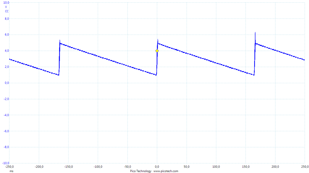

COMP pin

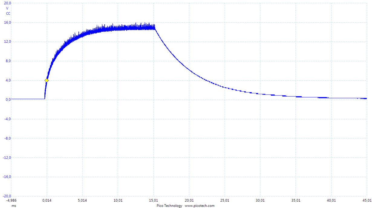

And Vout. We can see that output voltage is rising fast, when the hiccup stops the process.
  • D5 cannot be removed as it is needed to bias the U14.

    I know D5 is needed but I've removed it to simplify the design and finding the issue.

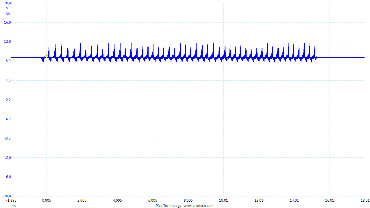

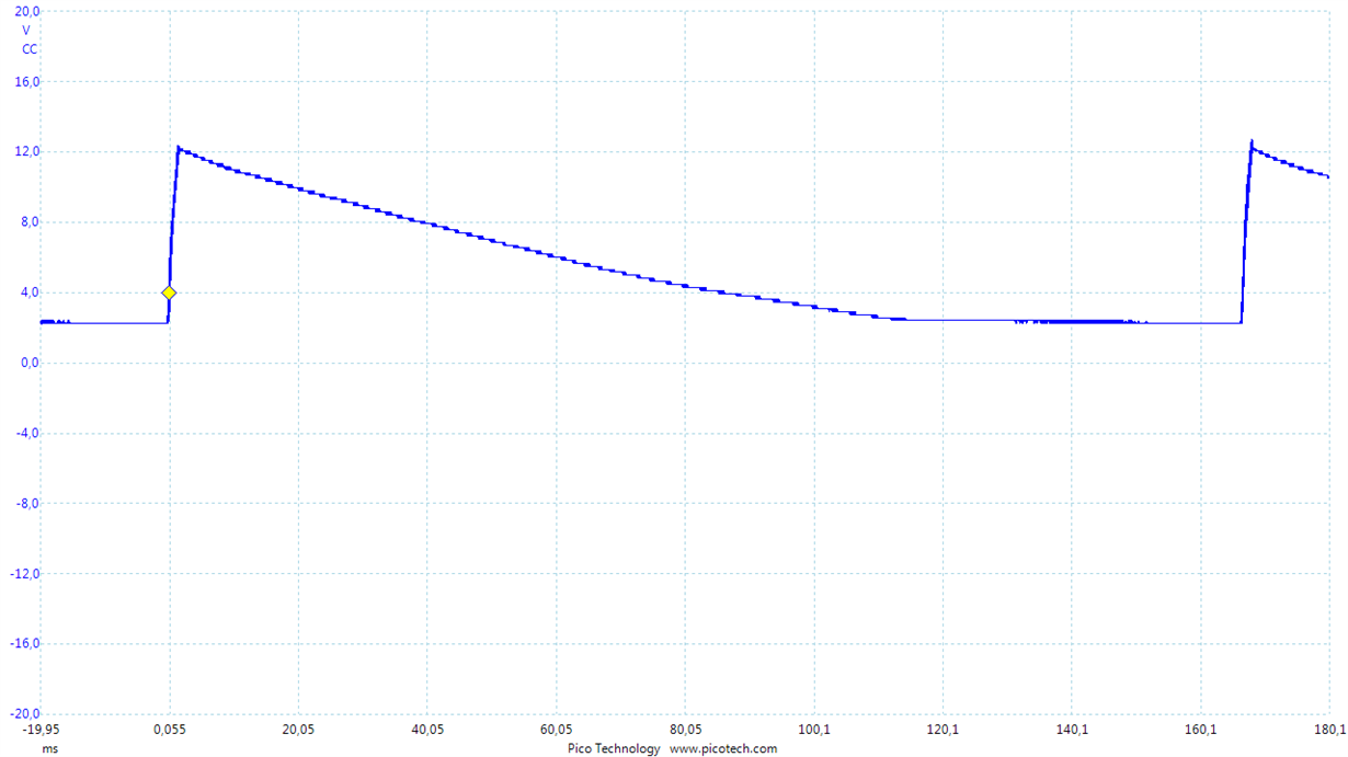

    When I connect a 50ohms load, here is what appens (Vout waveform and VCC waveform).
    Vout : We can see that the output voltage can't rise to 24V. The MOSFET turn on time is about 100ns at 267kHz so that's not a surprise.
    VCC pin waveform during PWM mode.

    Anyway, I was looking at the Rsense waveform and I think there is something really wrong here :
    If you take the 41uH (@ 100kHz) of the transformer primary inductance, take the DC impedance of (transformer's primary, MOS and Rsense - around 200mohms) and trace the transient waveform for 48V -> 2.3A after 2us. On my waveform, it goes crazy high in less than 0.03us. It's like I got a short circuit instead of the transformer's primary.
    There is something wrong here don't you think ?
