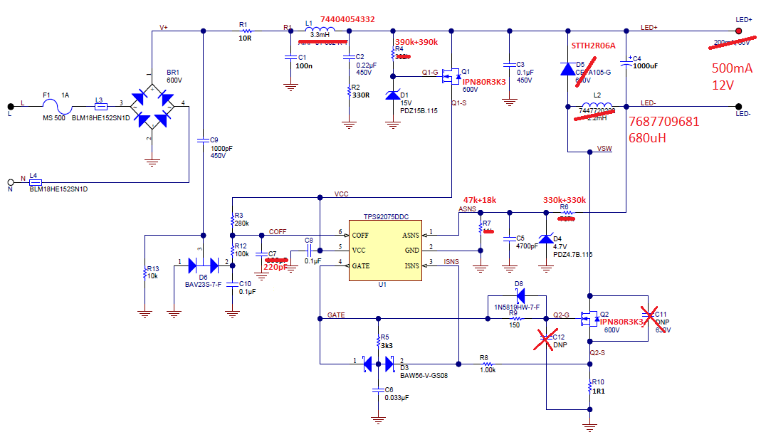

This is schematic:
On output there are 4 LED (series, 3Vx4 = 12V), Rsense is 0.95ohm to reach ~500mA

    I have some update, I replaced switching diode with SSTH2R06A and incremented values of R4, R6, R7, C7 using values of "designcalculator" spreadsheet  and PMP6016 evaluation board.
    Here is updated schematic:
    Its behaviour is better but I think it's not working well: using smartphone, I can see flicker on output and T2 (switching mos: IPN80R3K3P7) becomes hot.

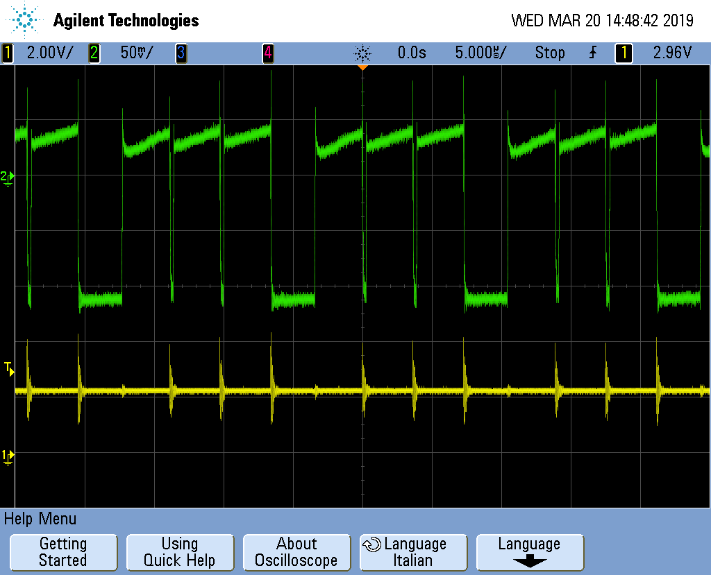

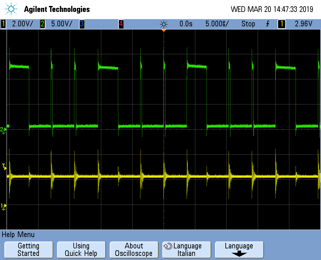

    I attach here DSO acquisitions to have your opinion.
    PIN1:
    PIN 1 yellow, PIN 3 green:
    Pin 1 yellow, Pin 4 green:
    Pin 1 yellow, Pin 5 green:

    A few things. I would try reducing R9, that value will add to switching loss though the diode has to be able to recover otherwise switching loss can increase (this is choosing the correct freewheel diode). Can you get an oscilloscope picture of the drain waveform near the peak of the rectified AC (this is high voltage)? ST has some that can work though they are not easy to figure out. Your switching frequency seems high for this type of design. I would try to be 100 KHz or lower. A few reasons for this, one is the leading edge blanking but the bigger issue is switching loss and other negative effects. Is it possible to have a higher LED stack voltage at lower current. This design is hurting you because of the step-down ratio making the switching loss much worse due to higher LED current. At 50V the LED current would drop to 125 mA or so.
    I don't understand the CS pin waveform (seems as though it's not consistent), also the circuit added to CS won't work correct at such a low duty cycle as it is. You can see the duty cycle in the last oscilloscope picture, between the two noise spikes is the on-time, the ramp is the off-time, duty cycle is very low (which is expected with 12V output 230 VAC input). At the peak of the AC the duty cycle would be 12V/230V*1.414 = 3.7%. It will be higher due to losses and the freewheel diode but you can see how short the on-time is. Lowering the switching frequency will help the losses a lot but the inductor may need to be a larger value.
    At a 12V output you may also run into problems with VCC. The VCC capacitor may need to increase but it would be better just to have a higher LED stack voltage.
    I increased R3 to 400kohm, reduced R9 to 39R, increased C8 up to 400nF and C4 to 2000uF.
    Frequency now is near 1000kHz.
    Light seems ok, but it has 100Hz flicker.

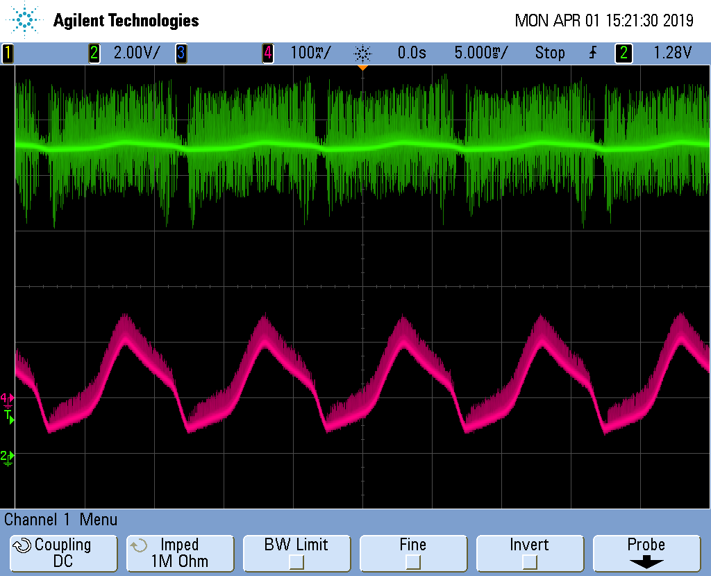

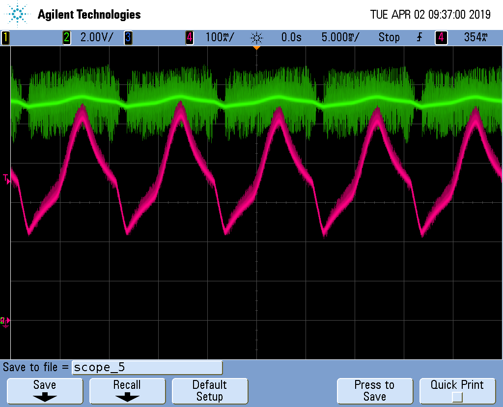

    Here is LED voltage and current:
    My design must have 12V 500mA output. Do you think that it is difficult or it is impossible?

    100 Hz ripple is going to be there, that is a function of power factor correction.  Also, your current waveform doesn't makes sense, it's going negative.
    Think about the conversion ratio, going from 230 VAC to 12 VDC isn't going to be optimum.  It can work but things like minimum on-time have to be checked.  The MOSFET and diode recovery will see 500 mA, if the output was 48V it would be one quarter of that making switching loss much less.  Also the percentage of loss of the freewheel diode will be higher, Vf/12V versus Vf/48V.  It can work, just not as well as it could.

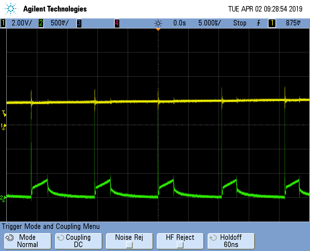

    CS pin waveform, sometimes there is a slope rise sometimes not and it's not consistent so I don't know what this is:

    Current was coupled in AC, here you can find DC waveform:
    And here you can find PIN 1 (yellow) and PIN 3 (green). There are 2 pictures, one with high values of Vasns and one with low values of Vasns:
    Now CS pin seems to have regular behaviour (with new values as reported on my previous post).

    TPS92075 may not be the best choice since the step down ratio is so high but other designs will be more complicated. The 100 Hz ripple is a function of power factor correction from 50 or 60 Hz, increasing the output capacitor value is really the only way to reduce it. What voltage rating are you using for the 1000 uF?
  • LED Capacitor is 1000uF 25V
    Thank you for your support, now I have understand better behaviour of TPS92075.
    If you used a 16V capacitor you could get 2X the value in the same size package. If your output is 12V a 16V capacitor should be fine.
