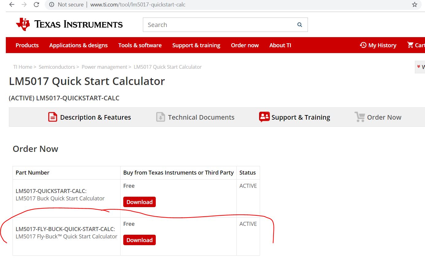

Hello TI,
Kindly point me to central repository for latest proven version of Calc xlsx sheet (Tried search in TI e2e as well as google, but all lead to e2e forum only)

  • Hello ,
    THe excel calculator can be found  in the product folder  under tool tab . There are two calculators there  ie buck and flybuck calculator :
    ---Ambreesh
  • Also you may refer to datasheet for all the formulas used int he excel sheet calculator .
    --Ambreesh
