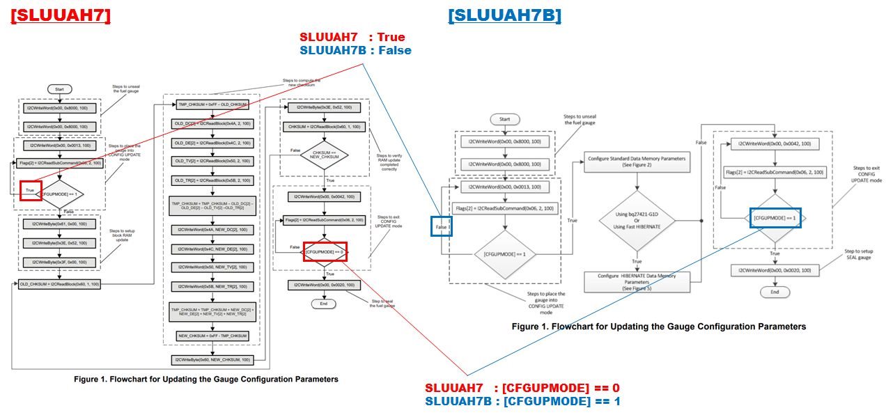

Now the customer is referring the Quickstart Guide for bq27421-G1 and then they found that there is different in Figl.1 between SLUUAH7 and SLUUAH7B. And regarding the condition to exit CONFIG UPDATE mode in SLUUAH7B, it should be False to exit it, not True. Is my understanding correct?
