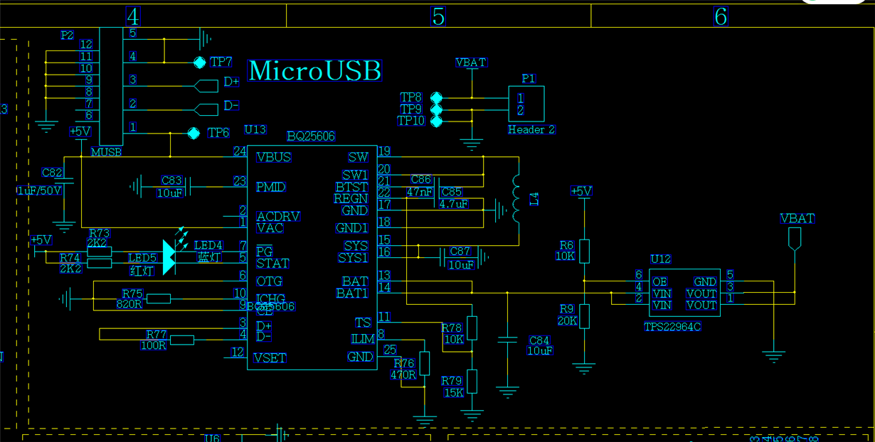

We are using BQ25606 for battery charging management. When the charging is nearly full, sometimes the stat indicator (LED5) flickers, and the battery voltage is 4.12v as measured by a multimeter.Re-plug the charging interface, and you can charge normally again.As shown in the schematic diagram above, what might be the reason?What can I do to avoid this

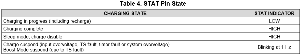

    The bottom row of Table 4 below lists all the conditions which can cause the STAT pin to blink:
    Looking at your schematic, input overvoltage shouldn't be an issue because your VBUS = 5 V. TS fault also shouldn't be the problem because you have a fixed resistor divider with no thermistor connected to the TS pin, so your TS voltage is always set to 60% of REGN.

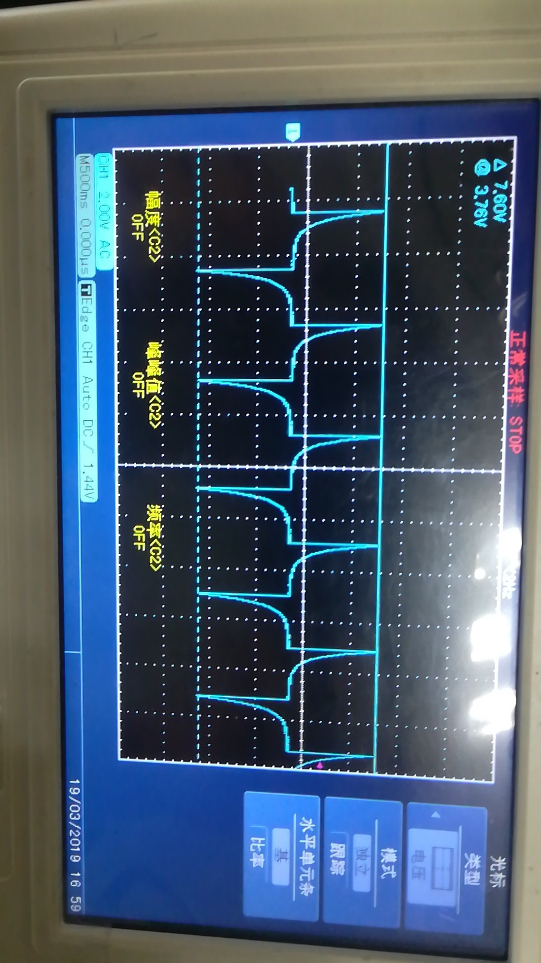

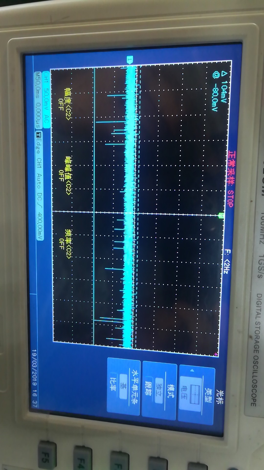

  • Thank you very much for your reply. Some test information is as follows
    VBAT pin ripple voltage is 25.6mv
    VBUS pin ripple voltage is 104mv
    STAT

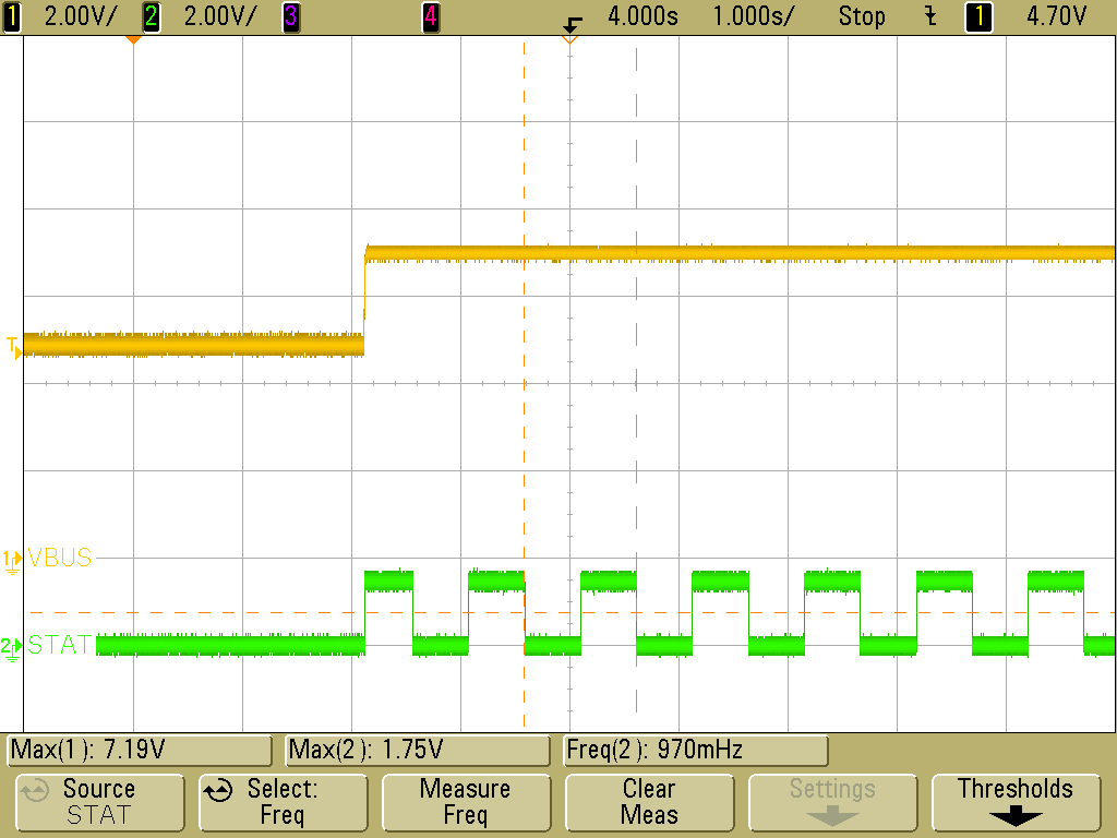

    I'm confused by your STAT waveform. Why does the voltage go negative? The STAT pin voltage should never go outside the range from 0 V to the pull-up rail, which is 5 V in your circuit. For example, in the waveform below, I increase VBUS to force an input overvoltage fault. The STAT pin voltage is a square wave that oscillates between 0 V and 1.7 V.
    Where exactly are you probing STAT? It might also be worth probing the 5 V pull-up rail just to make sure that something strange isn't going on there.
