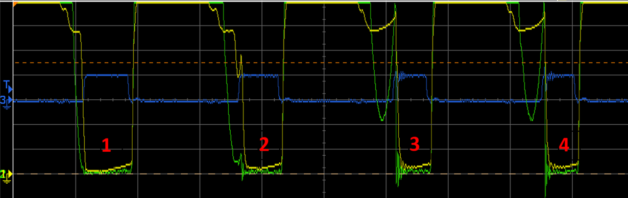

I have my supply going, but timing and resonance seem to be off or drifting.  In ABM burst mode I typically see a couple good switching cycles and then I start to see the switch node voltage not dropping to zero after PWMH goes low.  This causes the next PWML to be late and to miss zero-voltage switching. I am operating with SET = 1 which is normally used for Si FET switches, but my high-voltage GaN switches have large output capacitance so SET = 0 switches too quickly.
The traces below are yellow = SWS controller input at 2 V/div, green = high voltage switch node, captured at 100 V/div and zoomed in to 20 V/div with high-res capture, and blue = PWML at 5V/div.  Cycle 1 is normal, 2 is marginal, and 3 and 4 show the switch node voltage not reaching zero and late PWMLs.  The upper dotted line cursor is 9V, the SWT threshold to generate a PWML pulse.  You can see that SWT doesn't reach this threshold in pulses 3 and 4.
This behavior doesn't change with line or load, and I have tried a range of clamp capacitor values about 5:1.  I should also mention that my secondary current waveform doesn't look right either.  Instead of starting at zero after PWMH goes high it jumps to 2 - 3 A and seems to be resonating at the wrong frequency.  That sure seems like a bad clamp cap value, but changing that has little effect.
Any ideas?
  • Hello Gerrit,
    From the look of the waveform it does not look like there is enough negatavie current in the transformers primary to achieve ZVS.
    Could you check the value of RRDM it may not be sized correctly. Aslo double check that CSWS and RSWS are the correct values.

  • Hi Gerrit,
    Thanks for the Excel tips... I'll look into.
    Meanwhile, I'm sorry the "speed-up" cap idea didn't work. But I pondered the waveform some more and got to wondering if the opposite case may be at play. I wonder if the SWS network is getting advanced input too soon (rather than VS lagging).
    I wonder this because the 3rd and 4th switching cycle shows the green ring waveform (20V/div) not quite reaching 40V, yet the yellow SWS waveform (2V/div) apparently shows the tip of the dip at below 12V. If the switched node dv/dt is feeding forward to the SWS input before the VS sees the zero-crossing it may the same effect of confusing the tuner. I admit, I have no idea how this can happen yet... I didn't think it through thoroughly. But on the same V-scale (tough to do) the yellow and green waveforms should match fairly closely below ~13V; yellow clamped at ~13V when Vsw is higher. There normally should be a few ns RC delay at SWS.
    Unknowns: Is there something about the high-voltage depletion FET you have that is different from the BSS-126 part we've been used to using? Why does this phenomenon happen only in ABM and not in AAM? Does it happen in ABM at all of your input line range or only at/near one of the extremes? If at your low-line, can you try using a BSS-126 temporarily to see if it has any impact?
    Ulrich

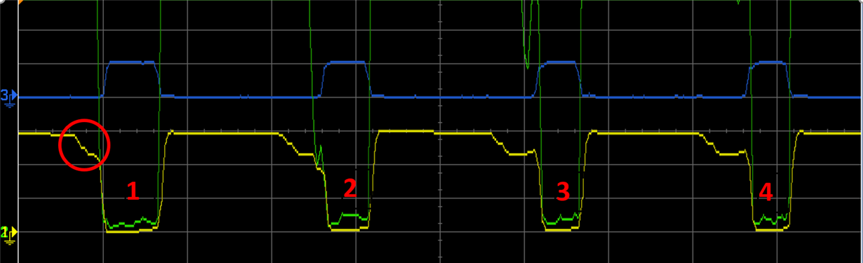

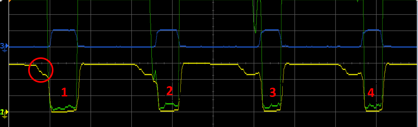

  • Hi Ulrich,
    I stared at those waveforms for a long time too.  There is a two-stage dip at the start of the SWS falling edge which I don't understand (shown circled below), but after that SWS seems to follow the switch node pretty well.  Below are the same waveforms as above, captured such that they didn't clip the scope, with SWS and switch node both zoomed to 5 V/div for display.  It's "high resolution" acquisition which on this scope reduces the bandwidth, but it looks like the switch node and SWS track pretty well after the circled anomaly (except for what looks like an offset error in the green switch node display).
    The circled anomaly does seem like SWS is somehow reacting to the switch node voltage well above the FET threshold. But this anomalous behavior stays above about 12 V so it shouldn't be affecting the timing from SWS.
    I'm using a CPC3982 depletion mode FET, which has specs close to the BSS-126 but a higher voltage rating.  I don't have any BSS-126's in stock here but I'll get some on order.
    My supply currently doesn't reach AAM even at full load.  There is something wrong there, but I thought I'd tackle the late PWML problem seen in ABM here first.
    My hunch right now is that SWS is tracking the switch node well enough, but the switch node voltage is not swinging low enough after a couple good pulses.  I mentioned earlier that my secondary current waveform doesn't look right either -- it's not starting at zero when PWMH goes high.  It looks like either the timing is off or the system isn't resonating at the right frequency.
    I will take a screen shot of the secondary current to show you what I mean, in my next post.

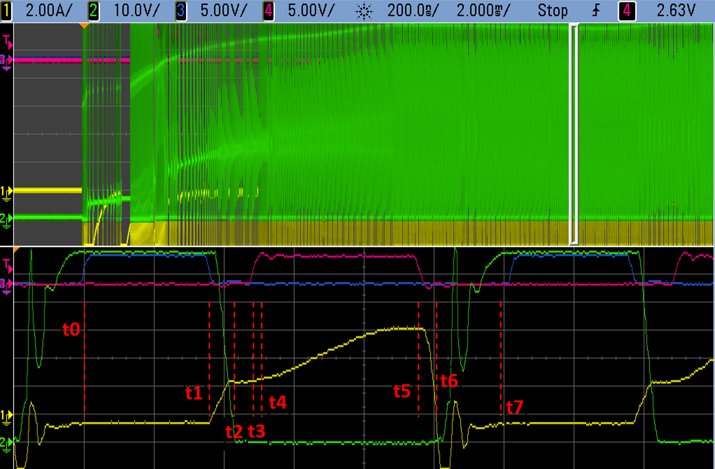

  • Hi Ulrich,
    Below is a screen shot from a few days ago.  It's similar to what I'm seeing now.  Yellow = secondary winding current (not necessarily DC accurate), Green = secondary winding voltage (dotted side), Blue = PWML, Magenta = PWMH.  The tN overlays in red mark the time instants in the Super Junction FET design article you include in your MathCad worksheet.
    This shows the secondary current jumping up to about 3 A at t1, when it should start smoothly from zero at t4 instead.  I think this out-of-resonance secondary waveform is part of the problem.
    Gerrit
  • Hello Gerrit,
    I'm sorry for my late reply; I've been working on the spreadsheet tool mostly.
    One thing I can say is don't worry about the sudden jump in secondary current (t1-t2). It is actually a good thing, and is a consequence of the differences in dv/dt's across the primary leakage inductance. Large SR-FET capacitance slows down the secondary dv/dt and a faster rising primary dv/dt pushes current to the secondary sooner, hence the step. It is good that the Isec does not ring back down to GND which keeps the SR from turning off prematurely and confusing the SR controller. This step is not an issue of concern.
    Since the Vsws and Vsw timings coincide quite closely, it's not an "advanced notice" problem either.
    So next try reducing your RDM value. I know it sounds like shot-gun approach, and it is, but I'm concerned that you have not been able to operate in AAM yet. I think this problem would occur in that mode, too.
    But if you are willing, can you send me your schematic file to ulrich_goerke@ti.com and I'll look at all of your parameters to see if I can spot something amiss.
    Ulrich
