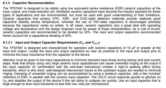

Hello all,
Regarding the TPS7A91 LDO:
According to the product's PDF, the minimum Cin/Cout is 10uF (page 4, section 6.3)
According to the TPS7A91 Evaluation board (TPS7A91EVM-831), Cin and Cout are P/N: GRM188R61C106MAALD (Murata)
if I take, for example Vin = 5V, and Vout = 3.3V, both capacitors have a actual capacitance (Under DC bias) far below 10uF
Is this fact taken for consideration?
