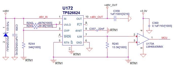

Hi Kari,
At the below E2E case, you asked as below.
ILIM pin has current information flowing through the external resistor connected to ILIM pin.
Connecting an I-V converter (with opamp -ve input connecting to ILIM resistor and +ve input connected to RTN) will give voltage corresponding to current flowing through load.
Please review below TPS26624 schematic if it can work analog current monitor output function or not.
