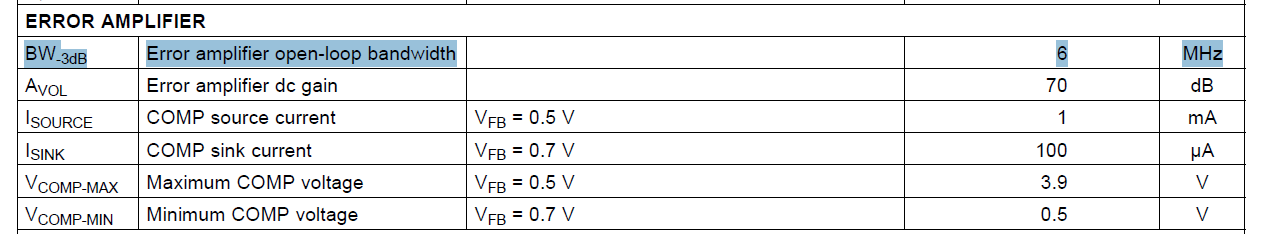

Team,
Looking into the bandwidth limitation on the LM27403 and see in the datasheet that gain-bandwidth product isn’t directly listed. Instead it seems to be called out as the open-loop bandwidth (see datasheet snippet below). Am I to take this to mean the Gain-Bandwidth Product is ~1.9GHz? This seems initially very unrealistic to me. Can you confirm?
