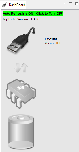

  • Here's the screenshot of the Dashboard window in BMS. Based on this I am guessing that the EV2400 device driver is properly installed, but it's unable to communicate with the BQ40z80 chip for some reason. Does the EV2400 version need to be updated? Does the chip need to be woken up some how? I've checked that it's being powered and I've moved to the two SMB jumpers to external. Are there any other jumpers that need to be moved?
    Sean

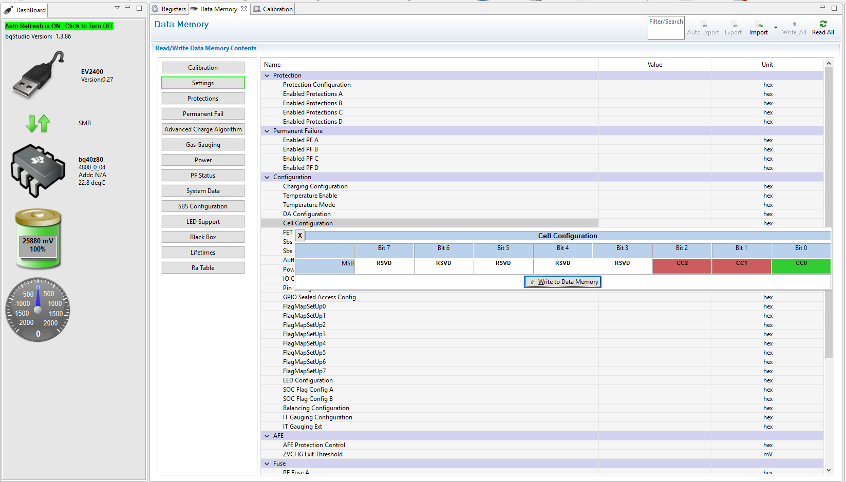

  • UPDATE:
    I was able to get the EV2400 to connect to the BQ40Z80 only when I am holding down the WAKE button, but a few seconds after release the WAKE button the connection is broken. Also, when I try to change any of the settings I get an error message that reads "Operation failed because initial read of all data flash failed."
    How do I set up the EVM to run even when I am not depressing the WAKE button and how to I get BMS to be able to read and write to the registers?
