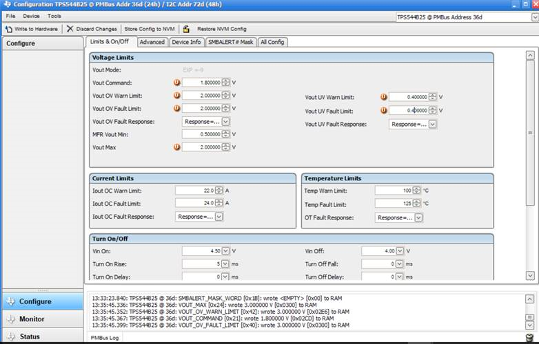

Setup 1: When I put below parameters in EVM, it doesn’t set the output voltage to 1.8V and returns a NACK while it works till 1.2 V. Below is the screenshot before setting voltage and after clicking write to hardware
Figure 1: Before programming
Figure 2 : After Programming

    The EVM as configured will not support 1.8 V output voltage thru PMBus command alone.  It will require hardware modification.  As built, the EVM does not have a low side FB resistor, VOUT_SCALE_LOOP is set to 1 and VSET is pulled up to BP3, so the output will be regulated to the VOUT_COMMAND value set point, 0.950 V default value.  The set point range fro VOUT_Command is 0.5 to 1.5 V, so that is the adjustable range.  You can populate R9 with 11.3 kohm to change the default output to 1.8 V without any PMBus commands.  Other options are possible, depending on your specific requirements.  Let me know if this works for you.  The various other possibilities with hardware and programming changes are discussed in detail in the data sheet.  Contact us again if you have further questions.

    You will at a minimum need to populate a bottom side resistor divider. The set point ranges are 0.5 to 1.5 V (VOUT_SCALE_LOOP = 1), 1 to 3 V (VOUT_SCALE_LOOP = 0.5) and 2 to 6 V (VOUT_SCALE_LOOP = 0.25). None of those combinations cover your full range. Let me check if it is possible to work around this. It may take a while as the person who supports this just recently left the company.
  • Nishant,
    You will absolutely need to cross over VOUT_SCALE_LOOP boundaries. While you can spoof the TPS544B25 to output the voltage you desire, you will confuse the fault detection and telemetry as it will be expecting a different voltage than you are actually outputting. If you really need to scale from 0.8 V to 3.3 V, then a much better solution would be TPS546C23. The VOUT_SCALE_LOOP option of 0.5 will support direct scaling of the output via the VOUT_COMMAND over a range of 0.7 V to 3.3 V. Let me know if that will work for you.
