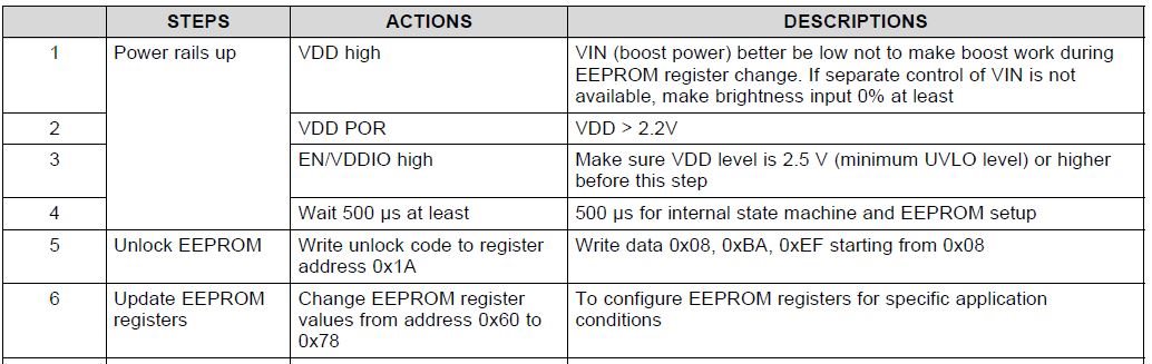

Hi All,
Also, only 00h-1Ah is reset after a power on reset or VDDIO / EN cycle, and the rewritten NVM is not reset.
Is this correct ?
Koji Hayashi
Hi All,
Is this correct ?
Koji Hayashi
Hi Shirley-san
Thank you for quick response.
I understood that what was written in NVM do not disappear unless it was rewritten.
I think that it only writes in NVM tailored to customer use once.
However, customers are planning to evaluate prototypes and may be rewritten.
When is it recommended to rewrite NVM (60h-78h) after applying power ?
Koji Hayashi
Hi Shirley-san
Thank you for response.
I understand.
Koji Hayashi
