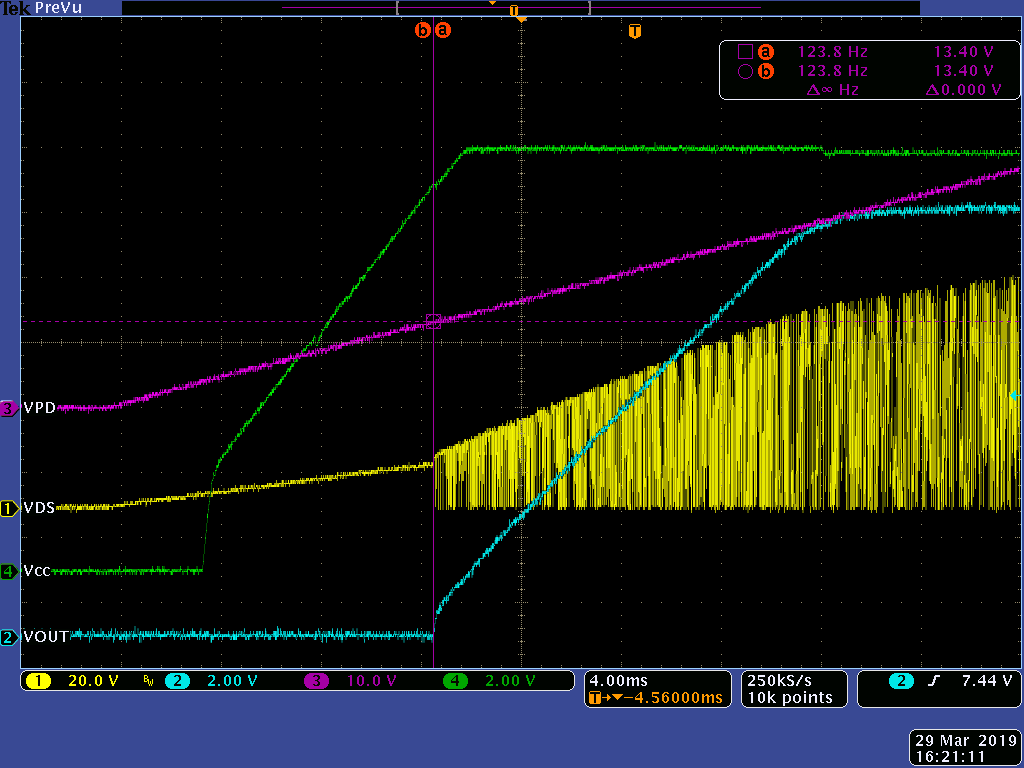

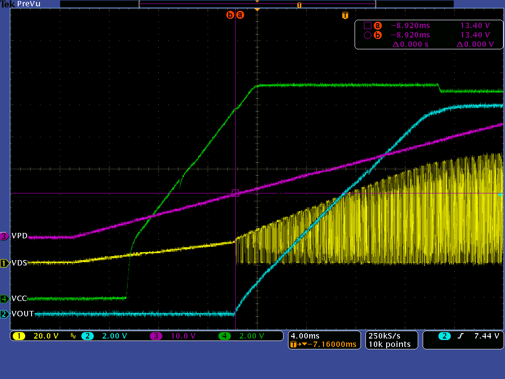

I found some questions when testing the TPS23755 EVM.
The converter should not start when the VPD voltage is below 35.5V.
below waveform shows that the converter is started when VPD is greater than 13.4V.
However,

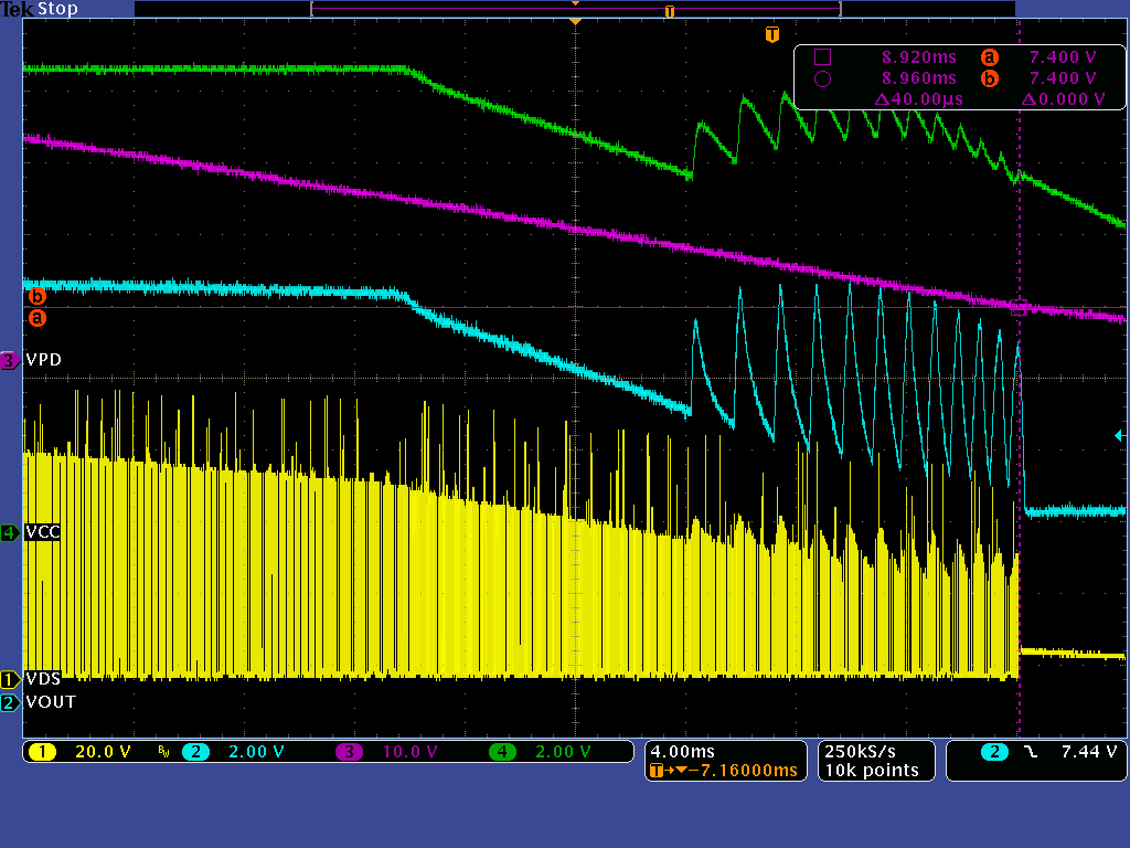

The same problem occurs when Vin is turned off, and Vout will restart when VPD is lower than 35V.
How can I avoid this problem?
