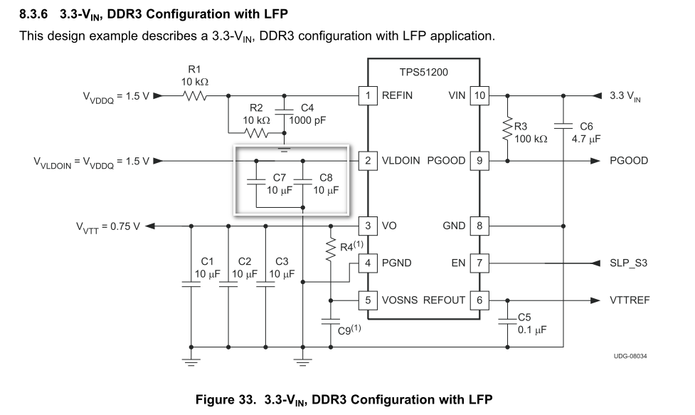

Regarding TPS51200, our datasheet specifies that INPUT capacitance of TPS51200 VINLDO must be larger than 1/2 OUTPUT capacitance. My customer wants to use 10uF+2.2uF capacitance combination for TPS51200 because they want to shrink solution size further. Except input cap is different, they are using below schematic. The load is only one DDR4.
Could you please check if 12.2uF is enough for this application? Thank you for your help!
