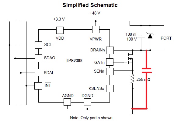

When testing Sifos, our customer found some error at the Sifos testing report, but after add cap on MOSFET side(as the picture below), this issue have been fixed.
May I know that what is the root cause?

Hi C.T,
As I as before, our TPS2388EVM passed sifos test 100% and it is EA certified. It doesn't need these caps to pass sifos. There are some known issues of sifos capturing the right timing and perform the measurement in the old versions. Please ask the customer to update their sifos firmware to the latest one and these failures should go away. Thanks.
