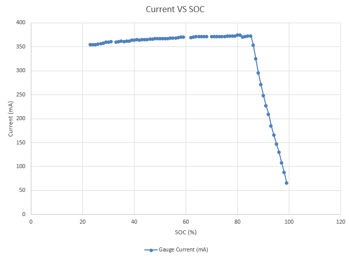

Im using a bq24230 in my design.
Riset = 2k94
Riterm = 2k94
Rilim = NC
EN1 and EN2 are set to USB500 mode
According to the datasheet my battery charging current should be limited to 296mA at nominal Kiset to a maximum of 330mA at the highest Kiset.
In CC mode I am charging at around a rate of 370mA and I haven't been able to explain why. the charger appears to be functioning properly.
Has anyone encountered a similar issue to this?
Luke

    Can you measure the resistance value of RISET on the board. Also what voltage do you measure on the ISET pin during charging?

    I am working in the project Luke is and I checked what you asked:
    RIset (measured) = 2941 ohm
    VIset = 2.04 V (DC RMS)
    I at time of measurement = 322 mA
    Thanks for your help!
  • Hi Leinho and Luke
    I am assisting Raheem with this question.
    When the BQ24230 is in CC mode, battery less than 4.2V the current control loop will regulate ISET pin to 2.25V.
    Also ratio of ISET current mirror to battery current is 1 to 380.
    With VISET = 2.04V the unit is not in current regulation, voltage needs to be higher.
    Battery current is measured at 322mA, with 1 to 380 ratio and 2941 R-ISET the voltage should be about 2.5V --- (322mA/380)*2941 ohms = 2.49V. Something is not right in the circuit.

  • Thanks for your help Bill. This is happening in at least 4 units. Due to high resistance between the battery and the BQ24230's VBat Pin, when the battery voltage is 3898 mV, the charger ic measures 4121mV and provides 357 mA. It should be in CC... The charger terminates correctly (as set).
