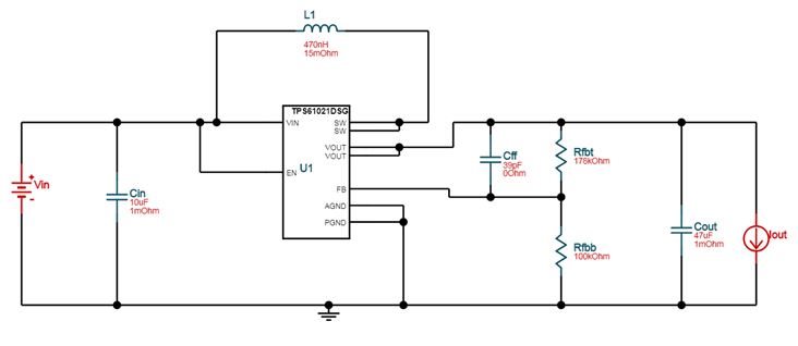

I am testing a design with the TPS61021A.
Input voltage is 0.9V to 1.8V
Output voltage is 2.2V
Output current is 100 mA
I have a design pretty similar to the webench attached. I have more capacitor on the input.
Inductor is the datasheet recommended from Coilcraft.

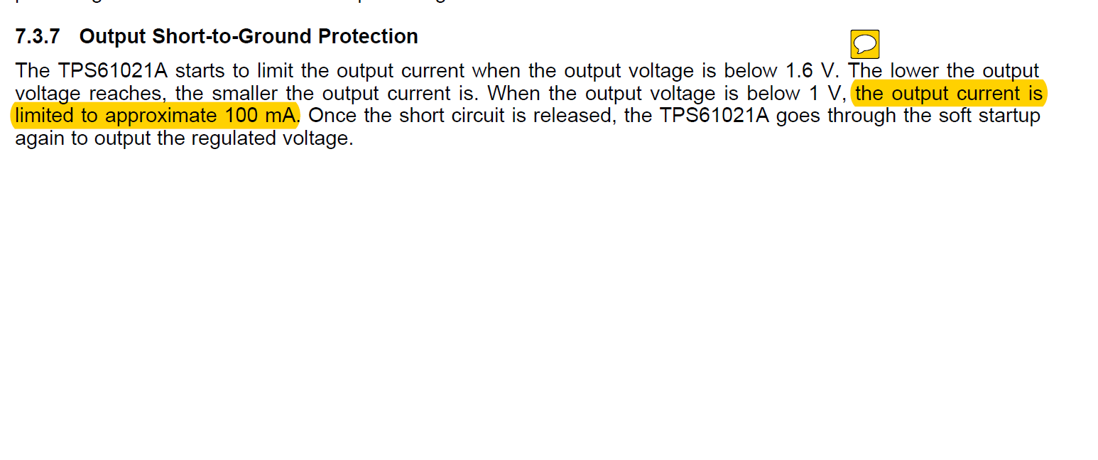

When I apply the power between 0.9V to 1.8V, with my small load connected (Resistor for 100mA current), the output voltage stays at around 0.7 V.
If I remove the load, the output goes at 2.2V.
What could be the problem ?  What needs to be checked first ?
Could it be the enable attached directly to Vin ?
Thanks !
