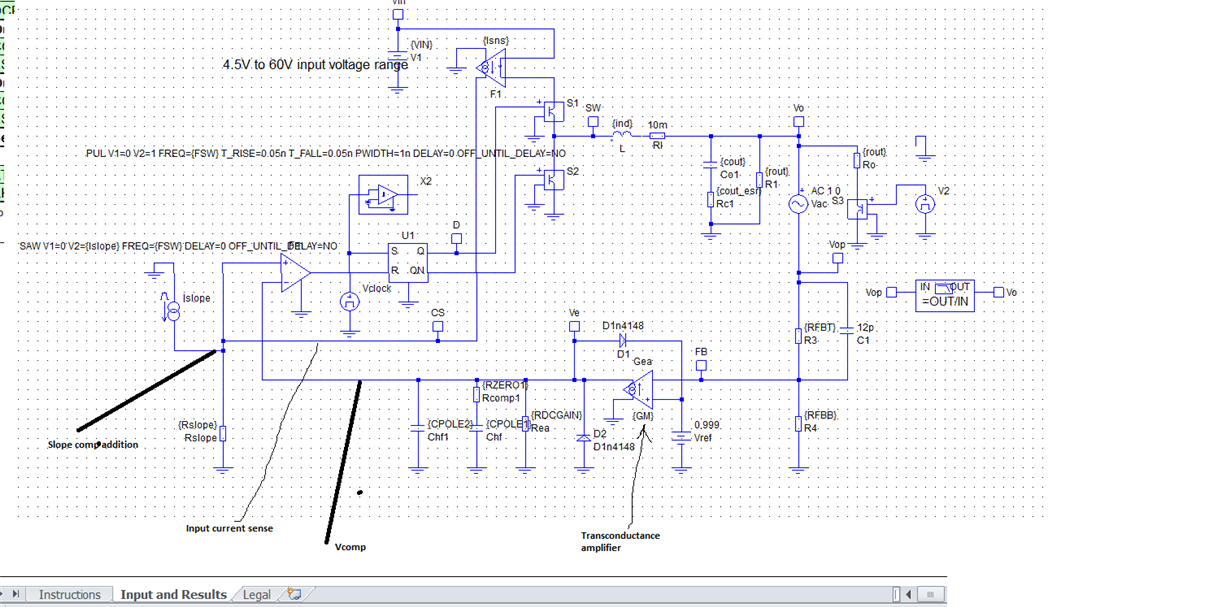

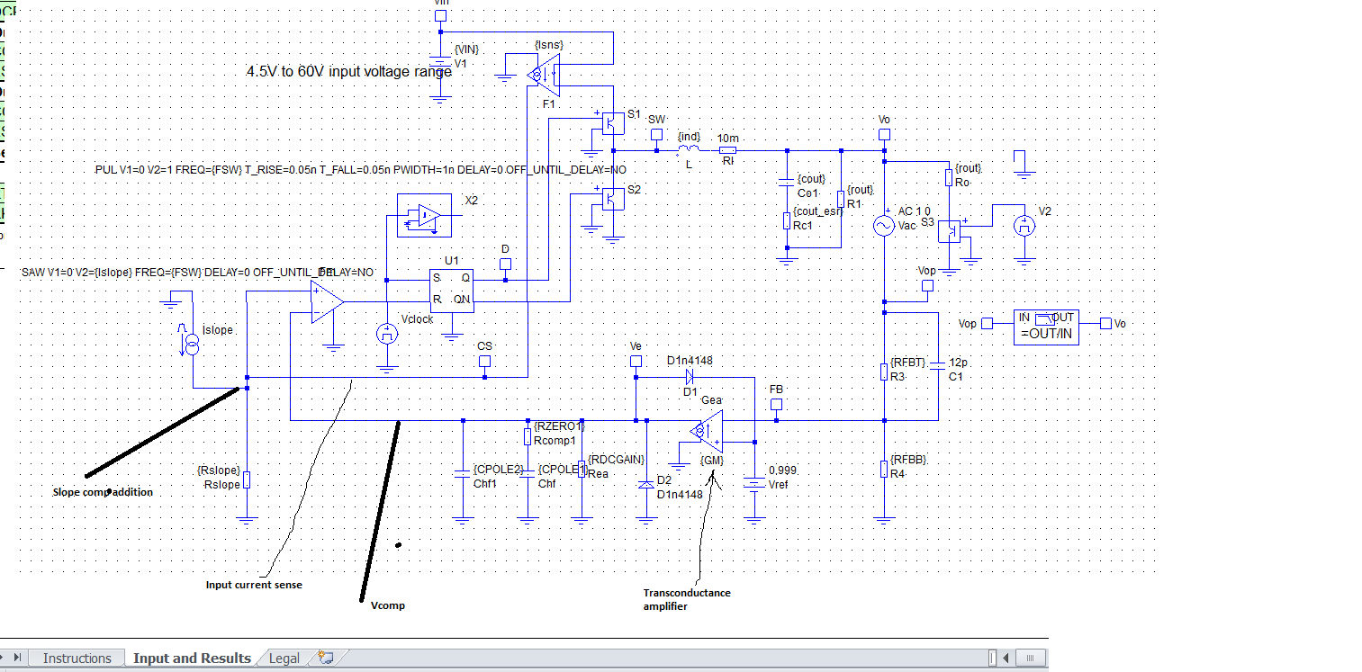

    below is how the simple peak current mode control looks like :
    So in short there are two loops ie slower voltage loop at the output and faster current loop  which reset the flip flop and the the high side FET is turned off .

  • 1) The equations associated with figure 16 are for a continuous conduction mode CCM buck converter. Therefore the duty cycle is independent of load, the duty cycle is equal to Vout/Vin. The average of the inductor current ramp moves up and down depending on load, so the peak to peak inductor current ramp and duty do not change for load in a CCM buck converter.
    2) The slope compensation ramp is related to the inductor current, and there is an equation in the LM5088 data sheet ( look at section 9.4.4). We also give an equation in the referenced paper EQ. 27 which shows the relationship. Please read through section 9.4.4 carefully. The benefit of a current mode feedback buck, is that it splits the complex congregate pole (found in a voltage mode buck) into a single high and low frequency pole. This helps to get more phase margin and bandwidth, which in turn gives better transient response. The catch is if the slope compensation ramp is too big, then it could force the converter into voltage mode feedback, and you lose the benefits of the current mode feedback. Therefore you need to set the slope compensation ramp big enough to negate sub-harmonic oscillation, but not too big as to force the converter into voltage mode feedback.
    3) The poles and zeros refer to a closed loop response.
