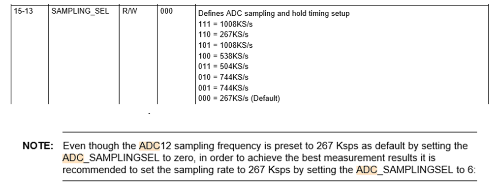

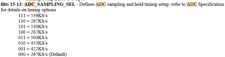

I found ADC sampling_sel can choose different speed .
But in the manual it suggest setting the speed as  267K. Now I want to get the more faster speed want use 538Ks/s or 1008Ks/s.
can I set the  register to 5 or 4? and  Using  more faster sampling speed,is possible  to affect my project ? Such the affect  interrupt event or other  function.
Or What should i consider in the project ,when i use more faster ADC sampling speed? Have any suggestion to set ADC sampling speed?
