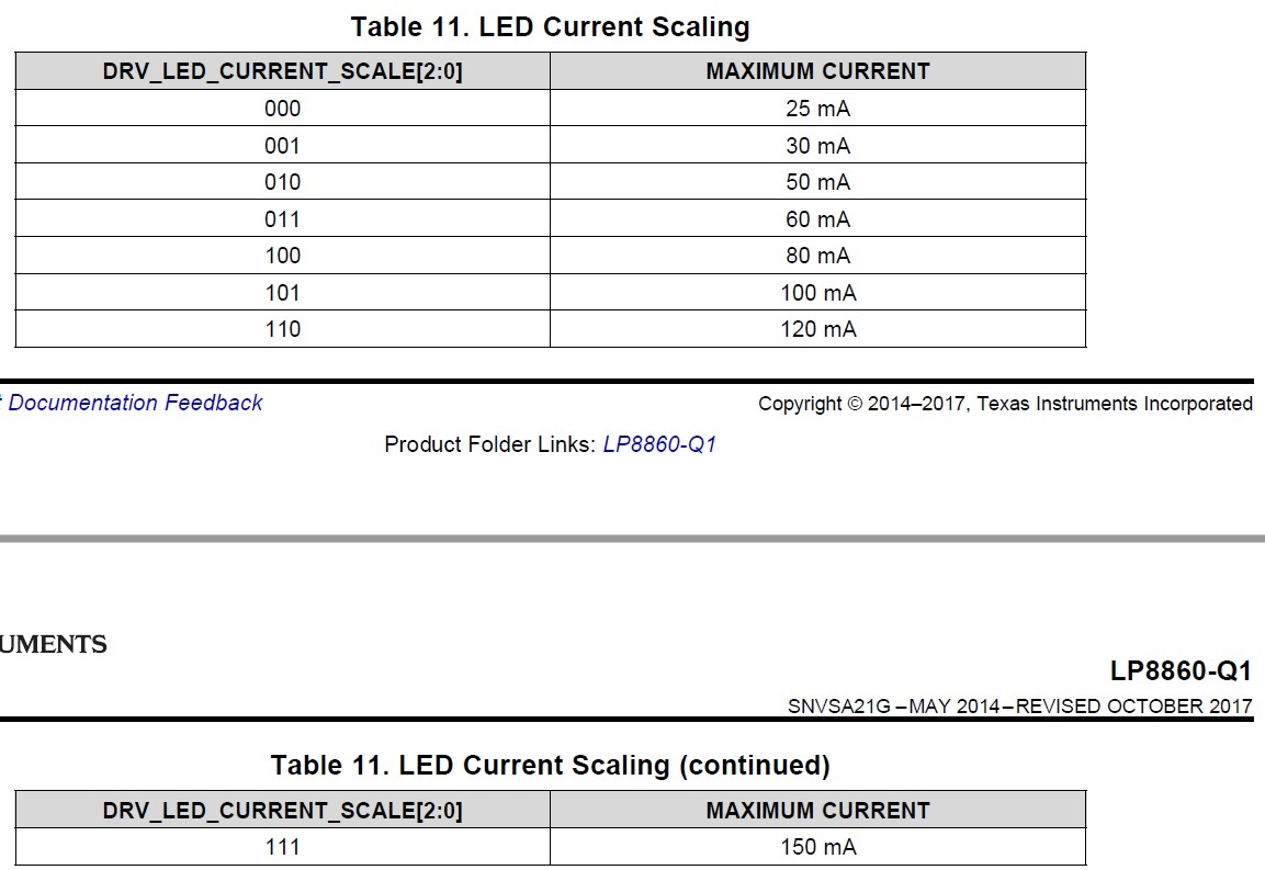

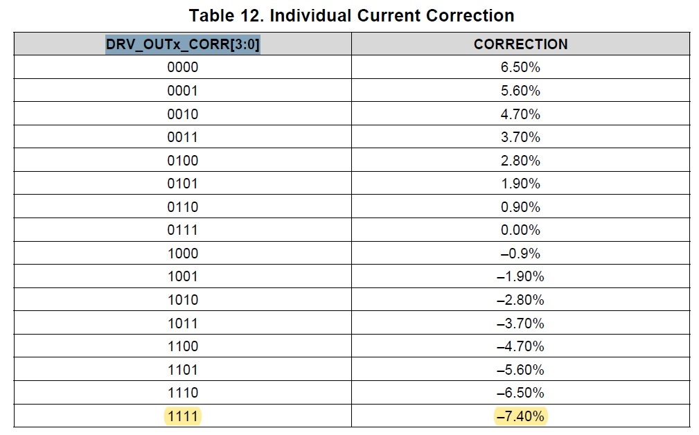

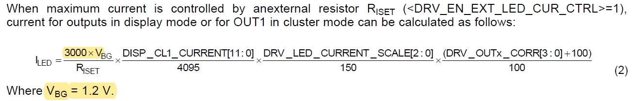

I had some questions about LP8860 spec.
1. in spec. page 31, what’s the VBG?
2. In spec. page31,
We choose DRV_LED_CURRENT_SCALE[2:0] =000 to get 25mA, then DRV_OUTx_CORR[3:0]=1111 to get -7.4%
So the minimum current in cluster mode is 23.15mA?
But we want 80mA/80mA/80mA/20mA
