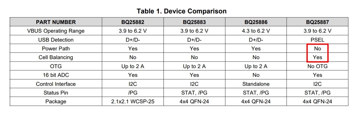

I am looking for a charger IC that have power path and cell balancing feature for charging of Li ion battery (18650), with the spec of
input voltage 4.5-12V
output voltage 5V/12V
output power ~10W
and the closest I've found is BQ25887 but is only for 2S charging, where I want to design for an application for 3S/4S battery pack.
Does that means there will always be 2 set of IC circuitry for charging the battery pack? the charger and the cell balancer.
As I am know little about battery charging, is there other things that I should take note of but missed? eg. battery protection

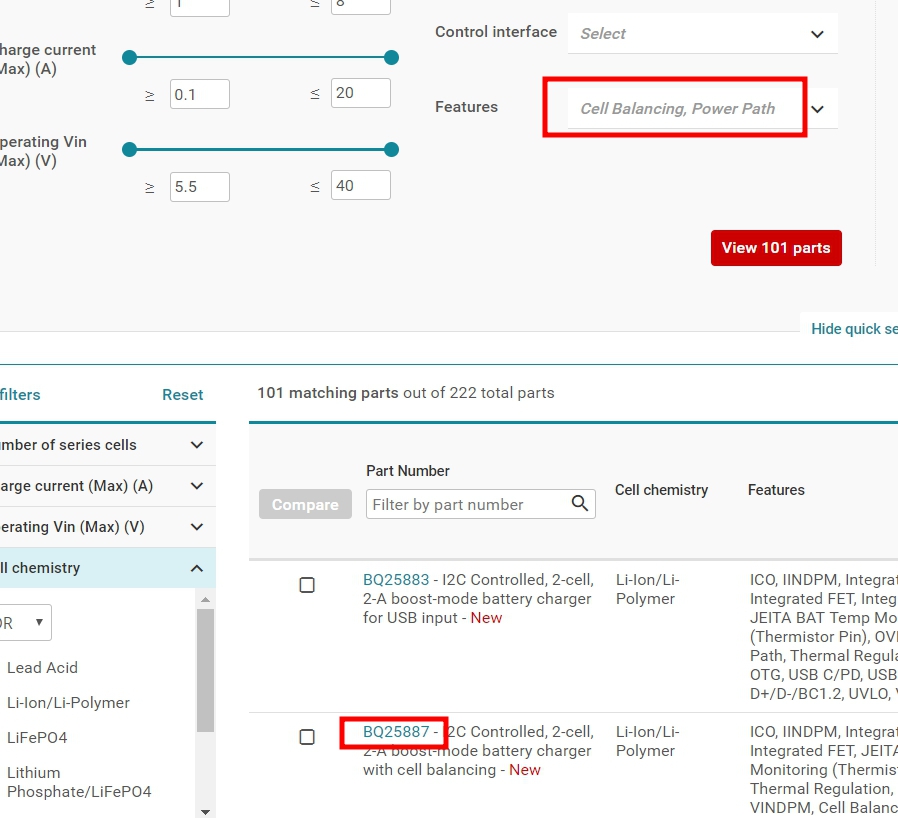

  • Hi, I believe there is some error with the component filtering function
