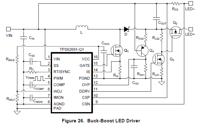

  • Hi Tuan,
         I find there are two MOS used in DDRV current control. I do not understand the advantage. could we use one MOS to realize the function? the attach is the schematic.
         About the L design, is the power used instantaneous power or average power?
        Thanks for your help.
  • Hi Shuang,
    For the TPS92691, the two FET's are used to level shift the DDRV signal to drive a high high switch for PWM'ing.  You can use the TPS92692 and this level shifting is done in the controller already so you only need the PWM'ing FET.
    Unless there are certain required specification, usually for LED's you specify the output current and voltage required and this is average power.
