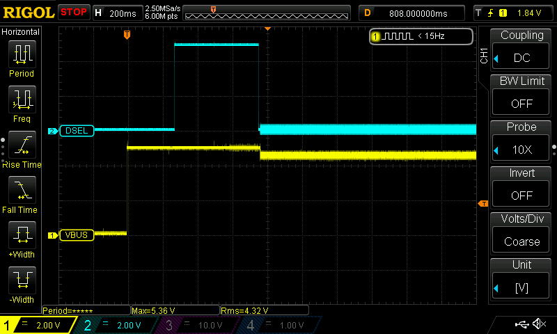

I measured state of DSEL pin with oscilloscope and i think it has wrong polarity.

I measured during input source type detection high and then go back to low. (oscilloscope screenshot in attachment).

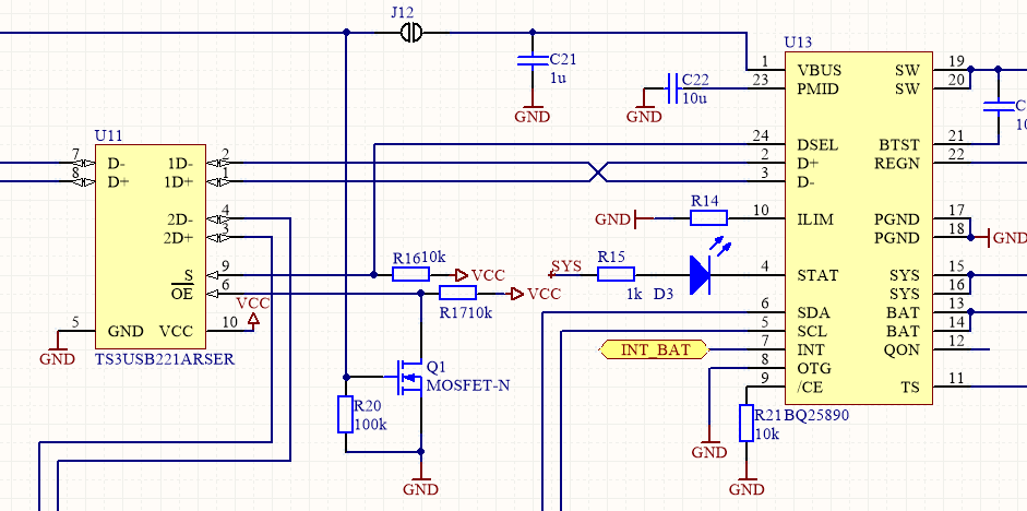

My connection is the same as connection in EVM. Why the DSEL signal si inverted against the datasheet.
There is schematic in attachment.

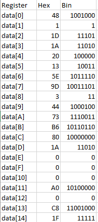

    Could you please share all the BQ25890 register values after the input detection is complete?
    Ning.
    Please click "This Resolved my issue" button if this post answer your question.
  • Hi Ning.
    Here is register values after input detection is complete.
    Thank you
    Jozef

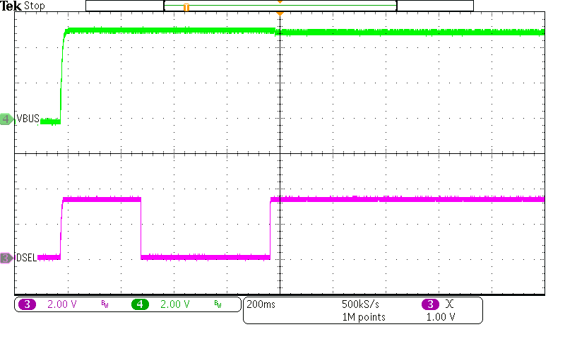

  • Jozef,
    I tried unknown adaptor on the EVM. It takes some time for DSEL to return to HIGH. Please refer to the waveform below.
    Ning.

  • Hi Ning.
    Thank you for your measurement on EVM.
    In my prototype never return DSEL to HIGH. After 10 seconds, 1 minutes, 10 minutes, is still LOW.
    At your measurement input detection run when DSEL is in LOW.
    At my measurement input detection run when DESL is in HIGH.
    Why? I used the same wiring as the EVM.
    PS: When I force connect DSEL to the ground, the input detection is successful.
    thanks
    Jozef
  • Jozef,
    As described on the d/s about DSEL: DSEL pin is normally float and pull-up by external resistor. During Input Source Type Detection , the pin drives low to indicate the bq25890 D+/D- detection is in progress and needs to take control of D+, D- signals.
    It is highly recommended to get familiar with the BQ25890 charger operation by testing the BQ25890 EVM (www.ti.com/.../bq25890evm-664).
    Ning.
