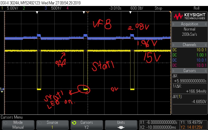

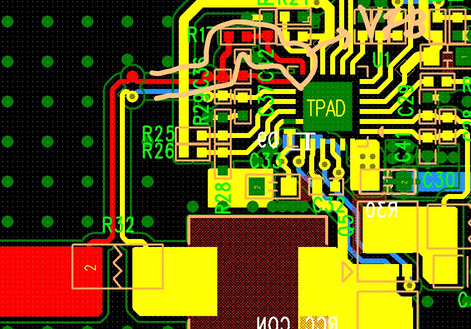

         When battery is near full charge, it is possible STAT1 is blinking as the converter interprets battery cycling between hitting charge termination and recharge threshold. This can happen when there is impedance in the path from battery to where charger measures battery voltage, which tricks charger into thinking charge is done. Can you take a scope capture showing VFB (if battery is near full, offset this signal by 2V on oscilloscope), STAT1, and charge current, when you observe STAT1 blinking?

    I rechecked atat1 become blinking.
    first time, stat2 turn on,
    next time( fulled battery insert on PCB again) , stat2 trun on.
    next time (fulled battery insert on PCB again) , stat2 trun on.
    finally (fulled battery insert on PCB again), Stat1 is blinking and stat 2 off..
    as upper photo, please check the  VFB net.
    I can't check right now you demand.
    next week I will send capture files.
    Would you let me know how to make impedance of VFP point more lower?

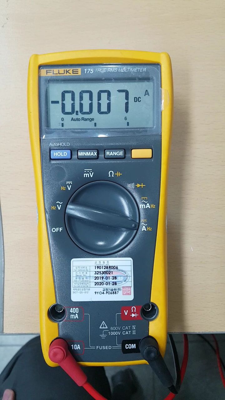

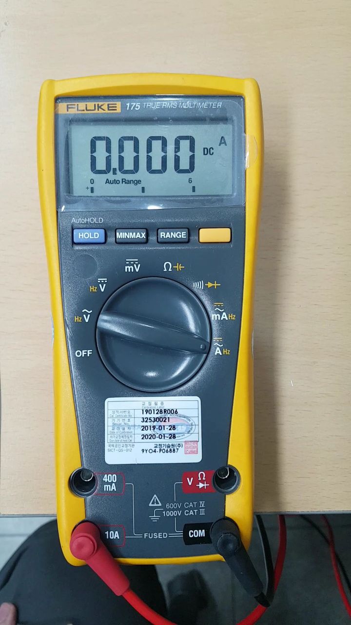

    on upper side, captured photo as you demand.
    we don't have current probe on Osciloscope. so, I mesured by DMM(Digital multimeter).
    as below,measured 0mA or -7mA repeatly.(probe(+),(-) point is Charge direction, ex) charge current is positive)
    Would you let me know about solution?

  • Hi Taehwan,
    It looks like your charger is cycling between hitting recharge threshold, charging back up, and then hitting termination again. There are a couple of possible reasons: 1) Too much impedance between VFB and actual battery pack. 2) Battery has discharge path, causing voltage to eventually reach Vrechg, and triggering a recharge cycle. The charger operation seems as expected. Can you confirm the time duration that VFB is 2.08V?
