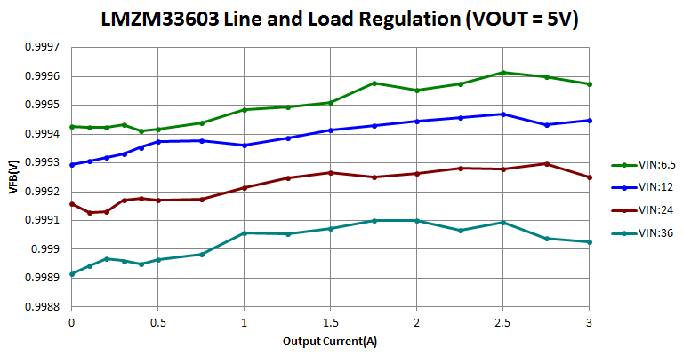

Do we have any data demonstrating the line/load regulation performance of LMZM33602? Thanks.

Hi Gregory,
Attached is a sweep of the feedback voltage with varying load currents. The curve that would most likely apply to your conditions is the VIN=24V (red line). Because this part has active-mode (FPWM), there will not be much expected deviation in feedback voltage under various load.
