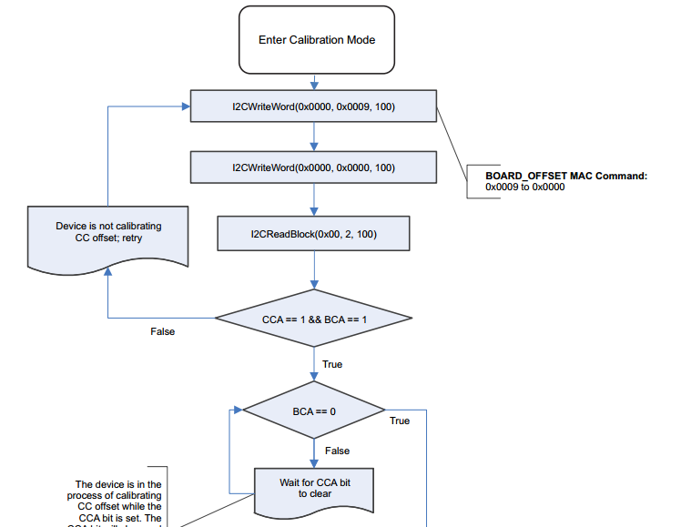

I'm trying to manage my Li-SoCl2 cell with bq35100  and there are some questions.I use MCU instead of  bqstudio  to calibrate the current。
1.When I do Board Offset , I can only get BCA = 1 from CONTROL_STATUS(0X00/0X01), not CCA == 1 &BCA = = 1. Is it normal ? In fact,I can get some data in df.
CC OFFSET = 0XFA 0X4D;    -1459mA?
Board OFFSET = 0X3A ;    58
I think it's right.
2.From my calculation, we get that the value of CC Gain is 0.04640,CC Delta is 55362.63.And I think that's the right value.But when I tried to verify the value in the CURRENT(0X0C/0X0D), I found it was wrong.
When I do not apply the load, the CURRENT(0X0C/0X0D) value is 0XBD 0XAD OR 0XFB 0X3F . When the load is working, regardless of the actual current, the CURRENT(0X0C/0X0D) value is 0X00 0X80.I can't understand.I do these measurements using ACC mode.

  • Here are my steps for cc calibration :
    1.GE = 1;
    2.send Gauge_Start()(0x0011) to 0x0000;
    3.send Enter_cal()(0x0081) to 0x0000;
    4.send CC_offset()(0x000A) to 0x0000;
    Then,I get the value of CCA is 1. Waiting for it to empty;
    5.send CC_offset_save()(0x000B) to 0x0000;
    Next is board calibration:
    6.send Board_offset(0x0009) to 0x0000;
    I can get the BCA = 1 but CCA = 0 .When I read the TRM 3.6 , BCA =1 &&CCA = 1 is the right value,but I don't know what I overlooked.
    7.send Gauge_Stop()(0x0012) to 0x0000;
    8.send  Exit_Cal()(0x0080) to 0x0000;
    END
    Even if CCA = 0 in Board_offset(), I still get the value of Board Offset, but I'm not sure if it's true.

  • CC Offset and Board Offset are values which are changed during the calibration procedure using the calibration plug-in. These short across SRN and SRP internally and open SRN and SRP internally when 0 current is flowing to calculate CC Offset (Short SRN-SRP) and Board Offset (Open SRN-SRP).
    CC Gain and Delta have internal units. These are to reflect AvgCurrent() and Qpass() registers. CC Delta is our coulomb counter setting and CC Gain is our current measurement setting. I would just follow the calibration plug-in and use values there after selecting a sense resistor.
  • In this calibration process, CCA = 1 can not be obtained according to the operation specified in the figure above.
  • Can you use bqstudio and perform the calibration routine for a reference which you can observe when to guide you in performing the calibration routine. If possible can you sniff the commn lines using an i2c analyser to see what bqstudio is doing when calibration is occurring. This will help guide you
