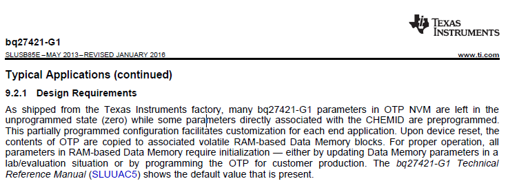

I have calibrated the BQ27421G1B chip for my battery pack and generated the golden image. I would like to program this to non volatile memory of the chip, but currently using the bqStudio I can only program the RAM. In our product we use a detachable battery and I would like to save the config ROM. I did some online research and could not find more information on this. The Golden Image file format is .gm.fs.
Can someone please tell me how to achieve this?
