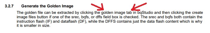

After completing a learning cycle on the BQ40Z60, what are the exact steps to save a golden file that can be applied to other BQ40Z60 chips?
The instructions I have found refer to a tab on bqStudio that does not exist. There is no "golden image tab" in bqStudio as is indicated in SLUA903-July 2018, page 7. The only way to save an image file appears to be the firmware tab and this saves an SREC file that does not carry the data memory parameters, as I have discovered by trial and error.
Please provide complete and specific instructions. It will save me hours of work, and believe me, I have already put in the hours to get to a completed learning cycle.

  • Hi, Aaron
        For how to modify the data flash after learning cycle, it has already be described in slua903, you can access via the link of "http://www.ti.com/lit/an/slua903/slua903.pdf"
        After this is done, you can extract the golden srec file, then use the tool bqProduction to download the data flash image to the target device, this tool is downloadable from the TI website.
        For how to use this tool, please refer to the file attached below:7433.0550.Taking your fuel gauge from design to production.pdf
  • Steven,
    As I already stated above in my request...
    Please ask an battery management expert at TI and let me know specifically how to extract the golden file SREC for the BQ40Z60.

  • Hello Aaron,
    I have seen your issue. I've submitted an internal ticket. I will take this offline. Will update you via DM.
  • I am seeing from another post that the GG.CSV file may be sufficient to program certain BQ parts, so perhaps the SREC "golden file"is not needed in my case???
    Is this appropriate for production on the BQ40Z60 ?
           Aaron
  • No, you can dump out the gg.csv, however there are hidden parameters which are in the srec. You will need the srec or what we call the bqfs. Both require the Golden Image Plug-In.
  • Ok, thanks. I look forward to hearing from you over direct mail for figuring out how to get the Golden Image Plug-In for generating the SREC and/or BQFS.

  • Hi, Aaron
       Sorry for not address your statement explicitly.
       My understanding is that you need a golden file for production, like conventional dataflash image(DFI) or something similar, one thing i shall point out is that the SREC file actually contain every thing including both FW and Dataflash information. when you select this file in bqProduction software, you have an option to determine whether to download the entire FW or the DFI it includes.
       Hope above information can help.
       Sorry for any disturbance it may incur if you think I have not understand your question.
  • Steven,
    Thanks, I appreciate your response.  So it looks like bqStudio using the Firmware tab produces the srec file with everything we need (firmware + data flash parameters) but bqStudio cannot be used for programming the entire srec file back into the BQ40Z60.
    So bqProduction is required for this. Do you know if we can use bqProduction with the EV2300 to program the BQ40Z60 over the SMBus connector?  Or do we need also to purchase the bqMTester hardware?  I am hoping that we only need the EV2300 for programming the part.
          Aaron
  • Hi, Aaron
        The bqMtester hardware facilitates VIT calibration, it is needed if you have no solution for VIT calibration for production
    Steven
