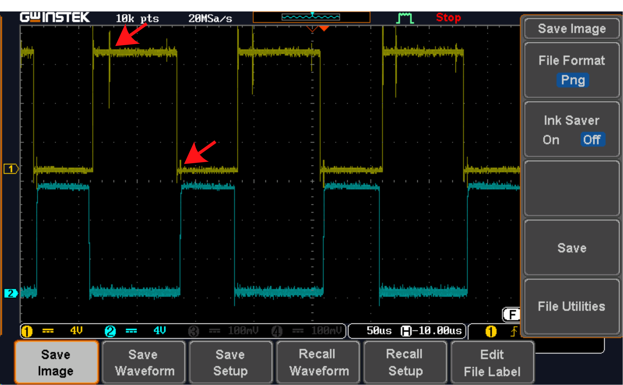

The signals that I got are the next ones:
  • in the first screen are showed the voltages at the gates, the blue one is the high side and de green one is the yellow.

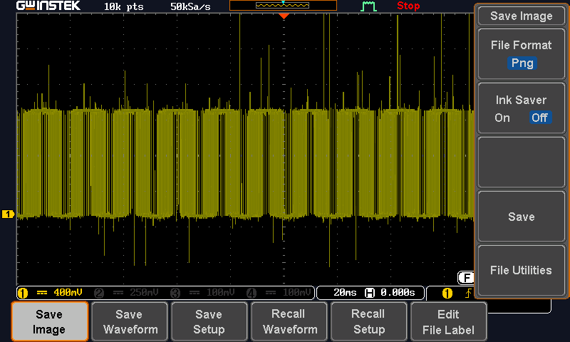

  • The second is the voltage between phases,
Is it normal to have those voltage spikes?

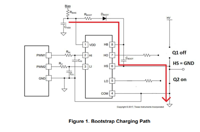

    2. "The bootstrap diode, what is it for?"
    This diode first role is to provide path from the supply cap Cvcc to charge the bootstrap capacitor during the off transitions of the high-side FET as shown on the diagram below:

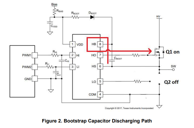

    During the high side on transitions, the boot diode blocks the charge from boot cap and protect the bias supply as shown below.
    You can further on this on the attached documents:
    Looking at your waveforms however, there is quite bit of ringing on the yellow waveform. Can you confirm whether that is the high-side gate or the low-side.
    The blue waveform looks reasonable on the other hand.
    Also please zoom-in on one to see how high the overshoot reach because if you exceed the recommended operating conditions, the driver might misbehave which might explain the damage you described.
    This overshoot at the gate may be caused by many factors including effects of parasitic inductance which occurs when the FETs are connected to the driver using long PCB traces. Is your high-side gate captured using a differential probe between high-side gate and switch node (SW)?

    I am curious to see what the switch node to GND waveform looks like.
