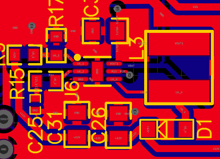

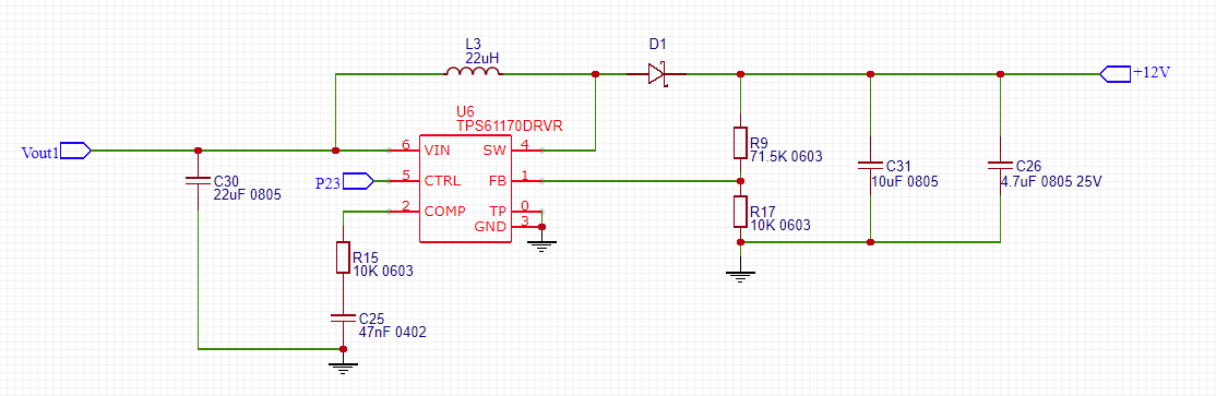

I'm having issues with TPS61170 design. First of all, it wasn't boosting the voltage to 12V. I replaced the diode and now its boosting but not in a right way. It gives 10V output instead of 12V. And the diode voltage drop is 10V - Vin! I don't really understand why. For example, I apply 8V, then I get 2V voltage across the diode. If I apply 7V, I get 3V across the diode. I replaced the IC and it is doing the same thing. Please help me!
I connected CTRL pin to VIN.
Thank you.
