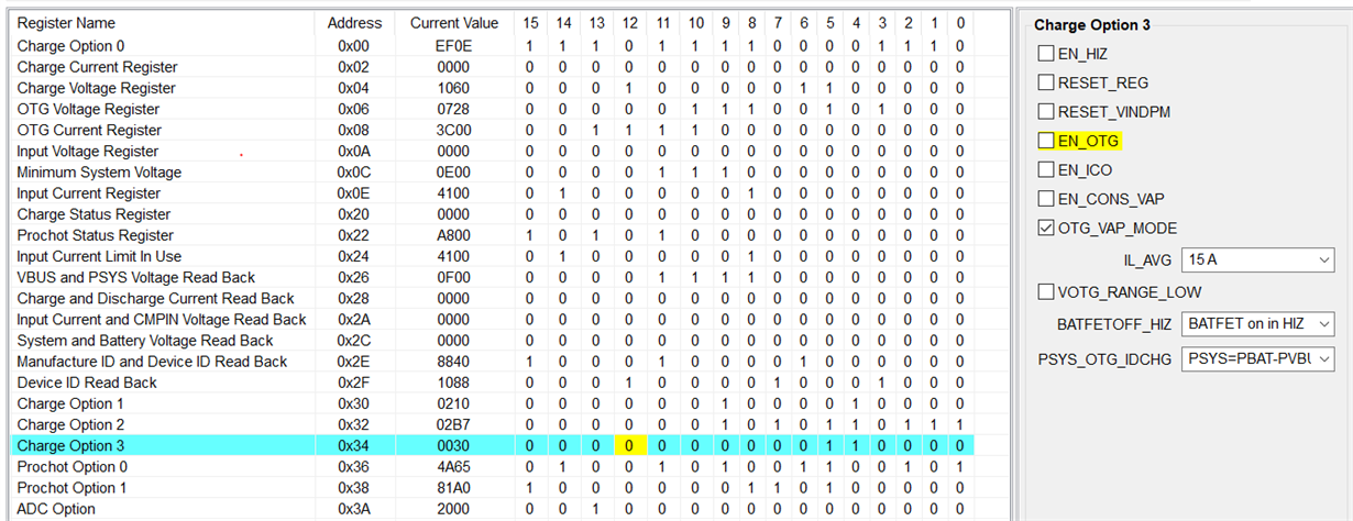

When BQ25713 OTG is EN, I can always see prochot turns low. And I found this is because VDPM protect is always on.
In my application, OTG voltage is 5V and Vin min(0x0A/B) is 3.2V. In my opinion, under this setting, VBUS detection should be 5V. Therefore, I can't understand why VDPM protect is triggered?
Look forward your kindly reply. Thanks a lot.

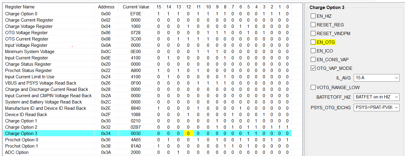

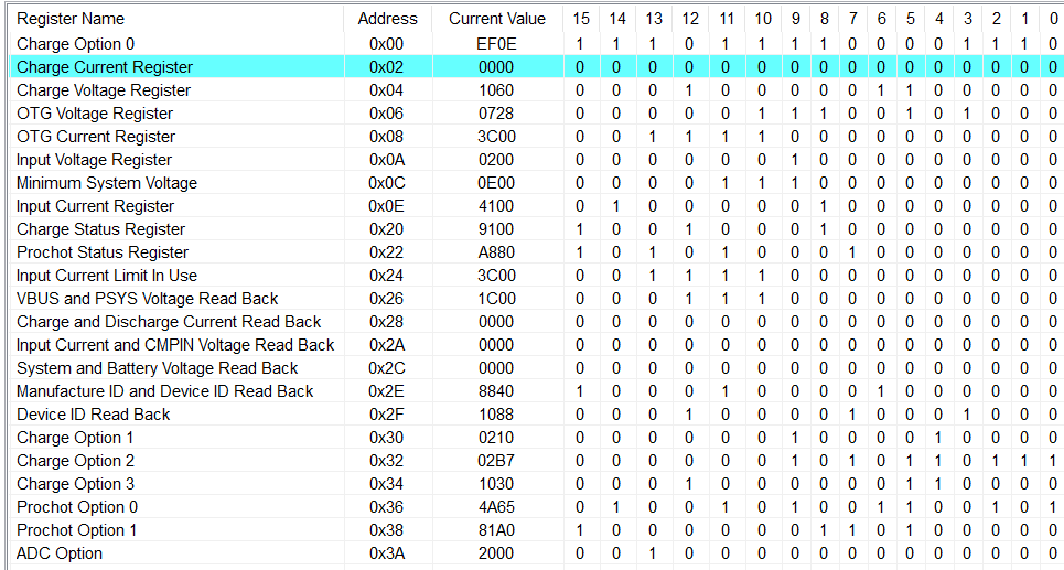

  • Thank you, Joel. This phenomenon can be found in both custom board and TI EVM.
    Below is the setting of EVM test.
    Vbus is only connected to a Voltmeter, without a source or load. A battery simulator is connected to Vbat with 3.6V voltage output. Vsys generated 3.54V accordingly.
    Charger setting can be see as below: OTG voltage 5V, OTG current is 3A min input voltage is 3.2V
    After EN_OTG is set to 1, prochot is turn low. And prochot status register STAT_VDPM is set to 1. The waveform of prochot and VBus is as below:
    Anything more to provide you, please feel free to ask. Thanks in advance!!!

  • Hey Wilson,
    The VDPM /PROCHOT flag is tripped whenever the input is not present AND the PROCHOT_PROFILE_VDPM bit is set (which it is by default). It cannot be deasserted just by reapplied a valid voltage. It must be manually cleared in the ProchotStatus Register, by setting 21h[7] back to 0.
    Now, if the PROCHOT_PROFILE_VDPM bit is set to zero in the ProchotOption1 register, the /PROCHOT pin will not be asserted for that type of fault.
