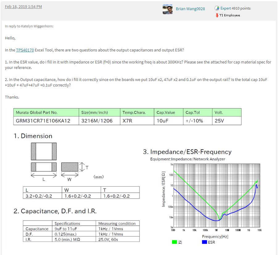

Hi Katelyn
I am interesting about the last question about output ESR and output capacitance.
Would you provide your suggestion?
Thank you
Amos.
