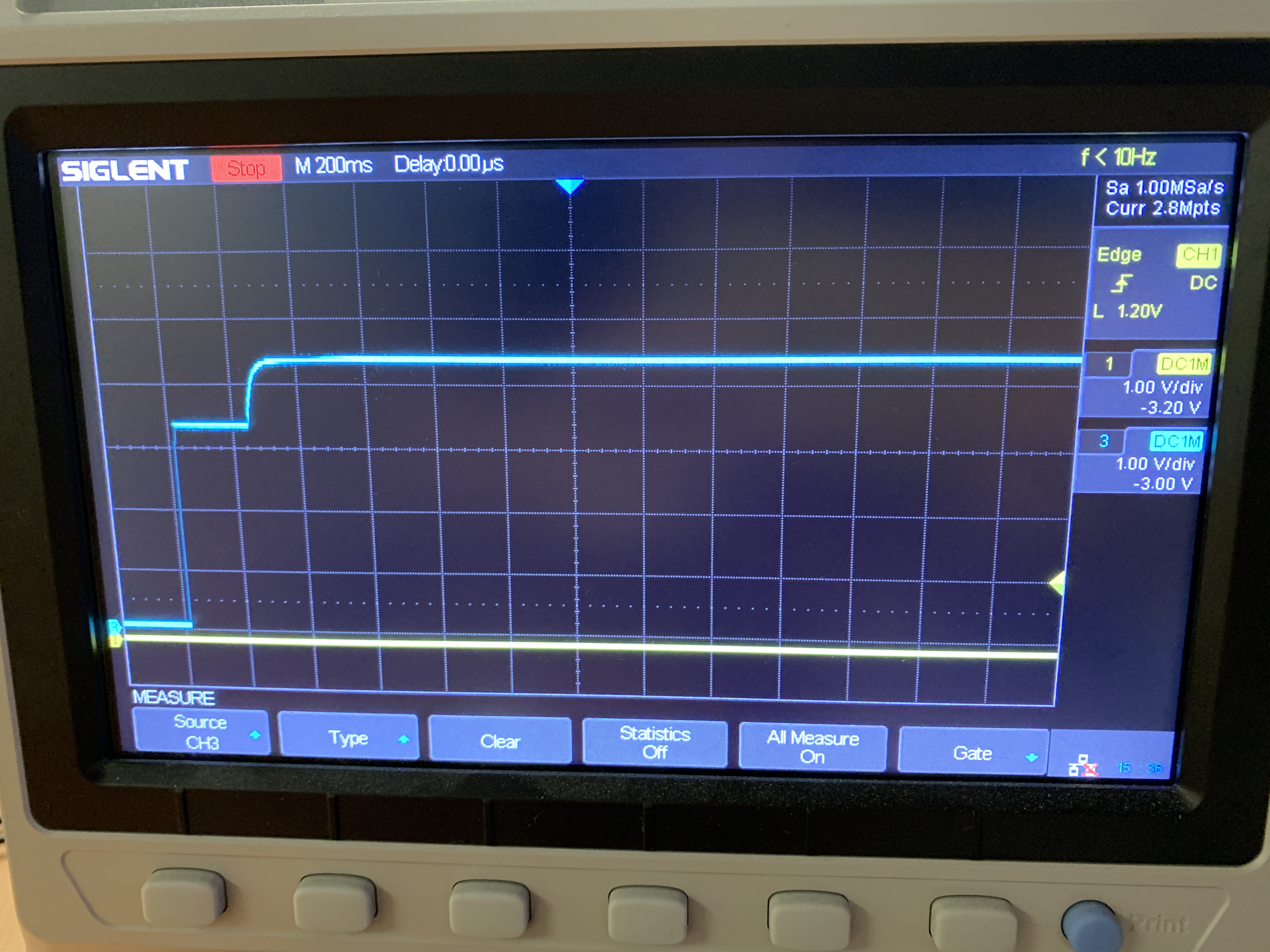

We have used the TLV62568PDD in our design to regulate a 3.3V supply from 5V nominal input.  The Power supply was designed using the Webench Power Designer.  We have designed for 400mA Imax, but typically we are only running at ~50mA.  We have noticed a strange issue on startup and MCU restart conditions where the load on the Power supply is drastically reduced to 550uA.  In this scenario, the output of the TLV62568 increases from 3.3V up to ~3.7V (12% increase), and the Feedback voltage increases from 600mV to 664mV.

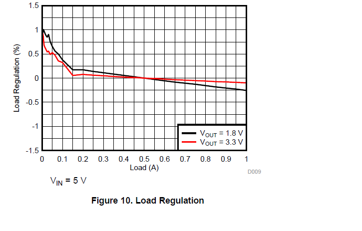

    This is not a normal behavior. As per datasheet, load regulation at no load at 3.3V output is ~1% (see graph below). In addition, VFB regulation is within 0.588V to 0.612V only.
    Does the output voltage stay at 3.7V or it drops to 3.3V after sometime with Io < 500uA? Can you give output voltage waveform at start-up? Please provide the schematic diagram, PCB layout and BOM related to the IC.

    Upon further testing today, I realise the power supply can reach nearly 4.5V in certain scenarios.

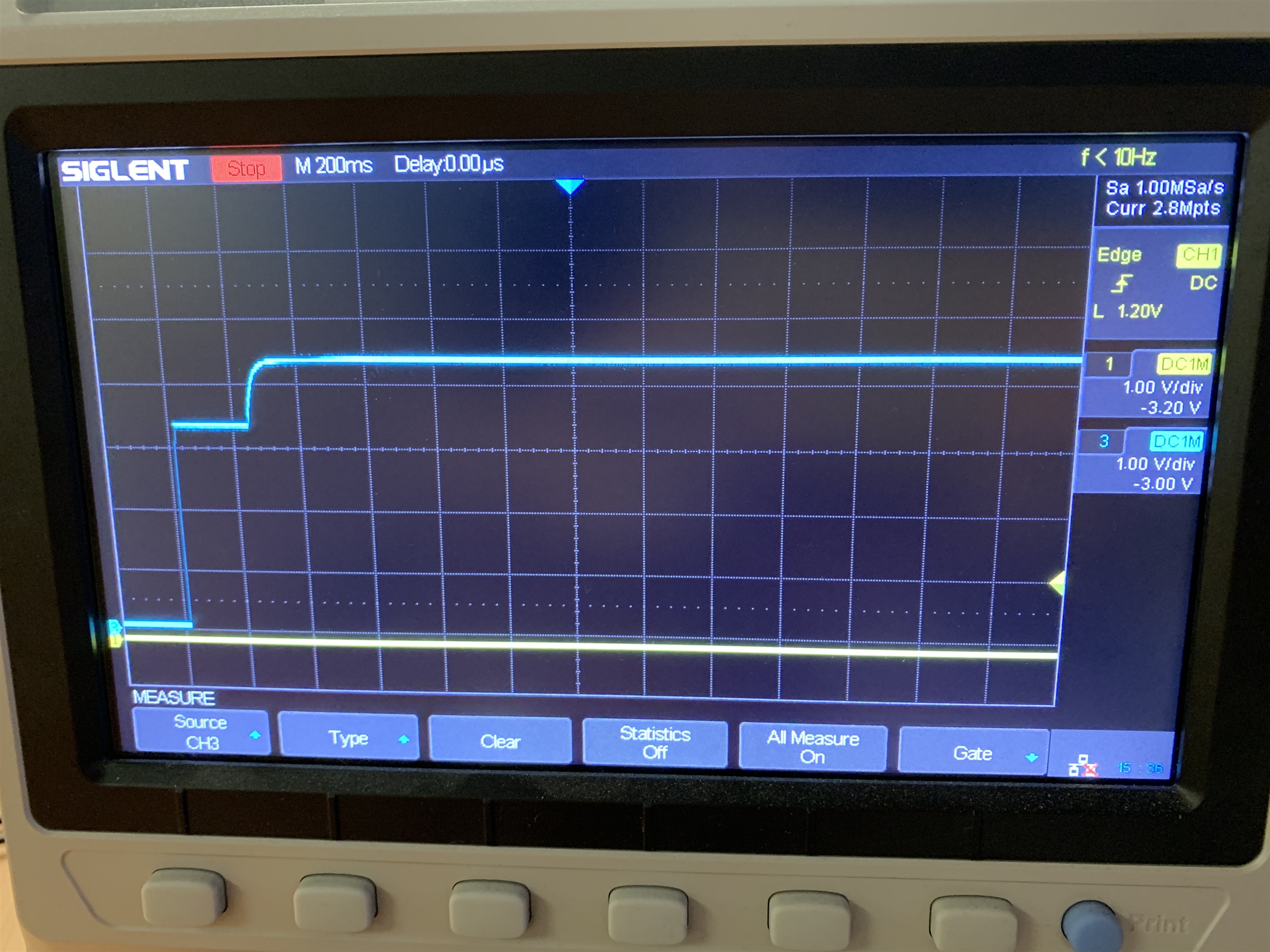

    The below image shows the output supply from the TLV62568 when the CC3220 is held in reset on powerup.

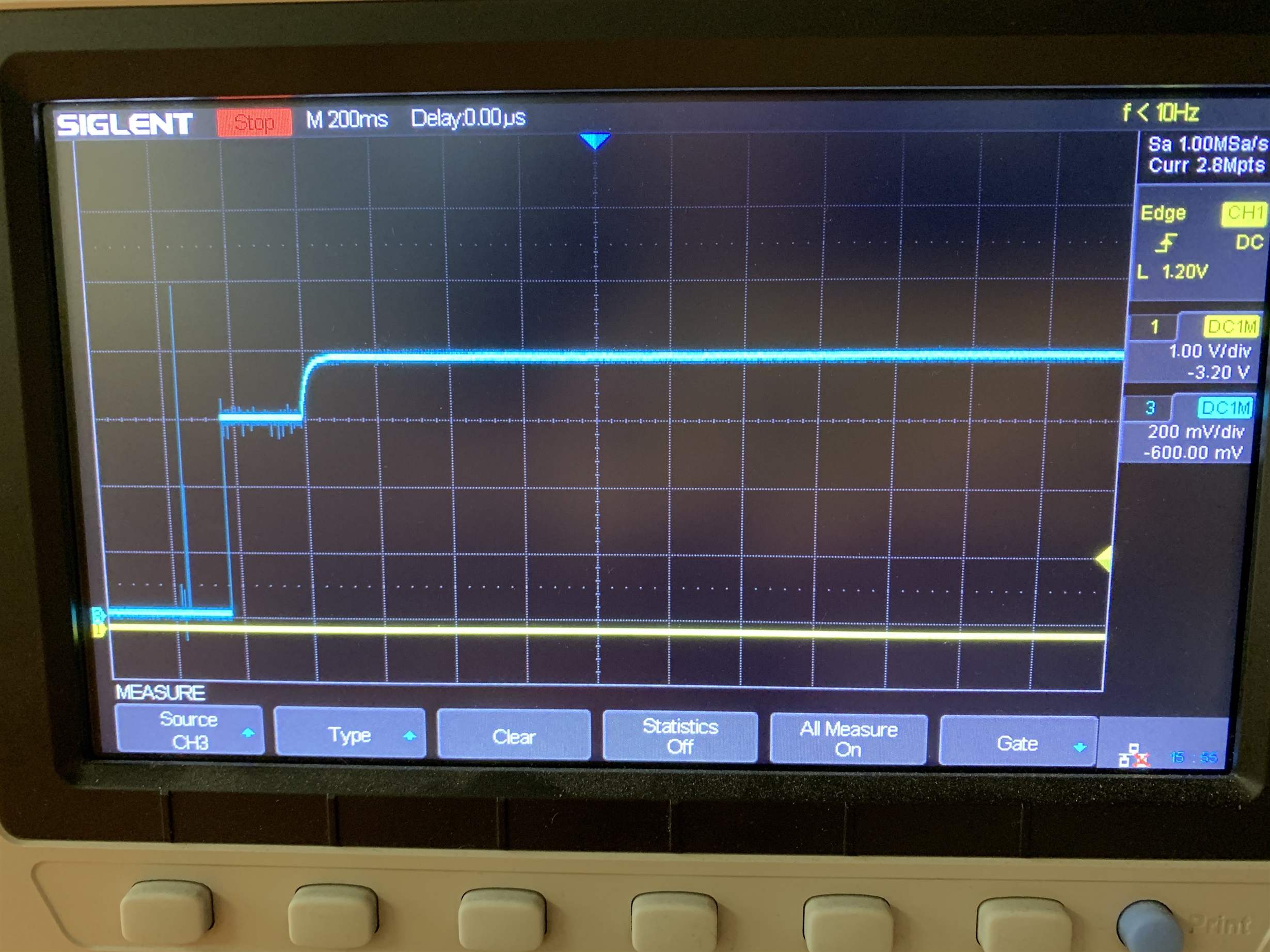

    Interestingly, the power supply is stable at 3.3V for approximately 200ms before it increases and tends towards 4.5V.  To answer your question, the Power supply does not recover unless I increase the load current.
    Image showing the 3.3V TLV62568 output on startup with CC3220 held in reset and output current <1mA
    Image showing the feedback pin of TLV62568 output on startup with CC3220 held in reset and output current <1mA

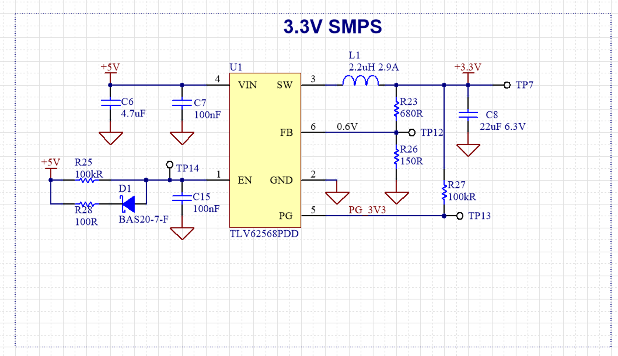

    The Schematic is as follows:

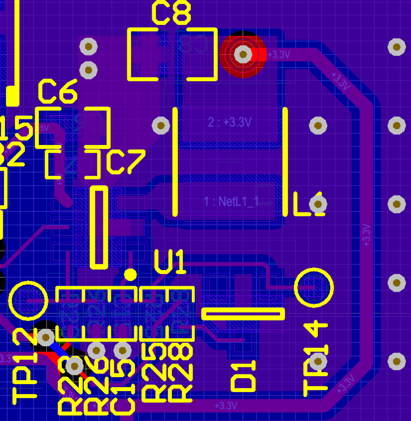

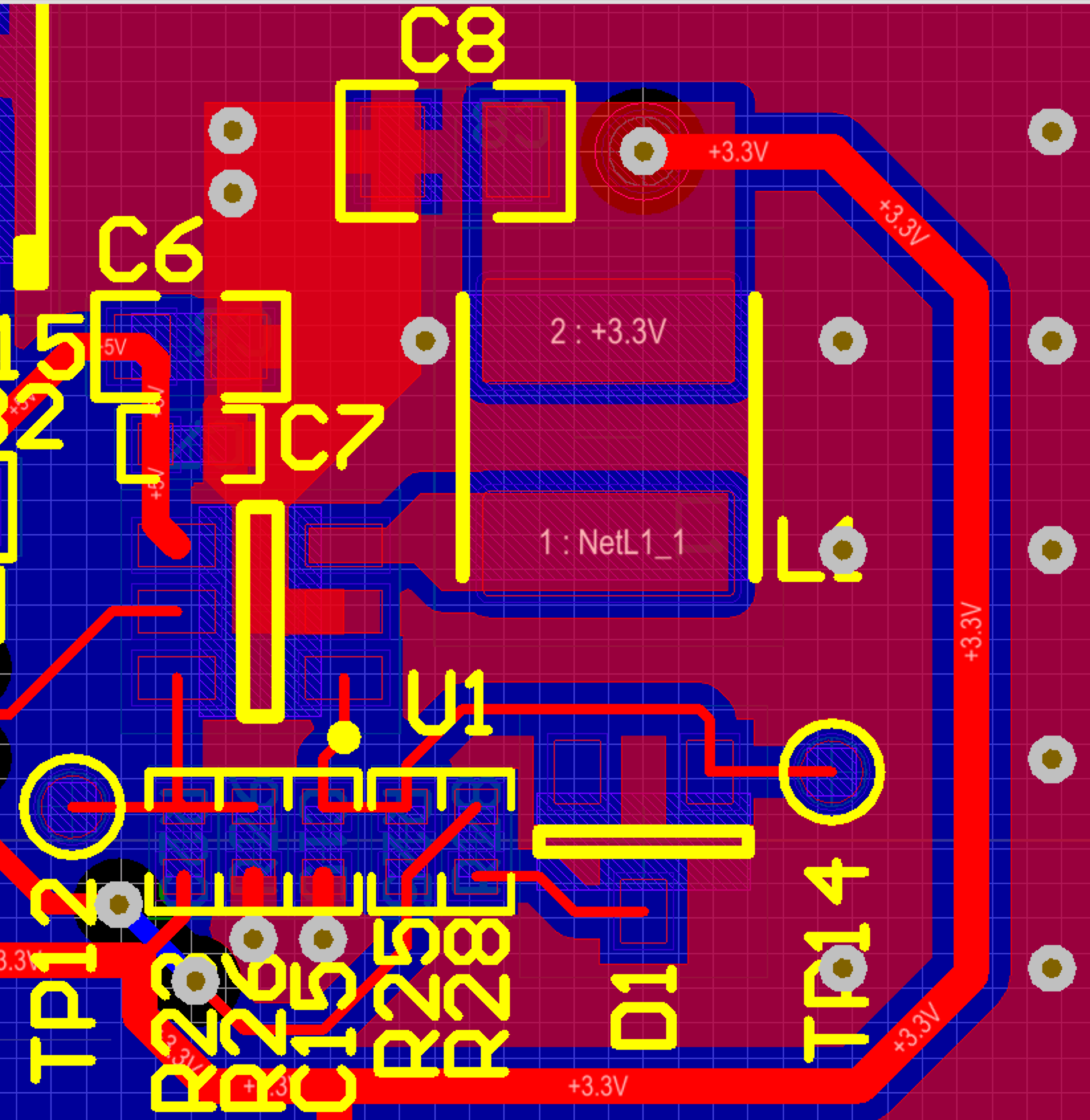

    The PCB is 2 layers and is as follows:

    The resistor divider going to FB pin should be connected as close as possible to the output cap (C8). However, there is a long loop from the output cap going to R23. If my suspicion is correct, this same trace goes to CC3220 which makes it susceptible to noise that can disturb the voltage regulation of the FB pin as well as Vout.
    Can you try to disconnect the pin of R23 which is connected to 3.3V and then use a short jumper wire to connect it to C8? I hope this bypass the noise on the FB resistor divider.
    In addition, I noticed in your schematic diagram that the resistor divider (R23 & R26) values going to FB pin is quite low compared to the BOM list. What are the correct values for R23 & R26? If it is 680R and 150R, can you change it to 100K and 435K similar to the BOM list?

  • Hi Excel,
    Thank you for your comments and suggestions.
    Regarding the discrepancy between BOM and Schematic, please note the resistors are currently as per the BOM. I updated the schematic to increase the idle load on the Power supply and forgot to screenshot prior to making the changes.

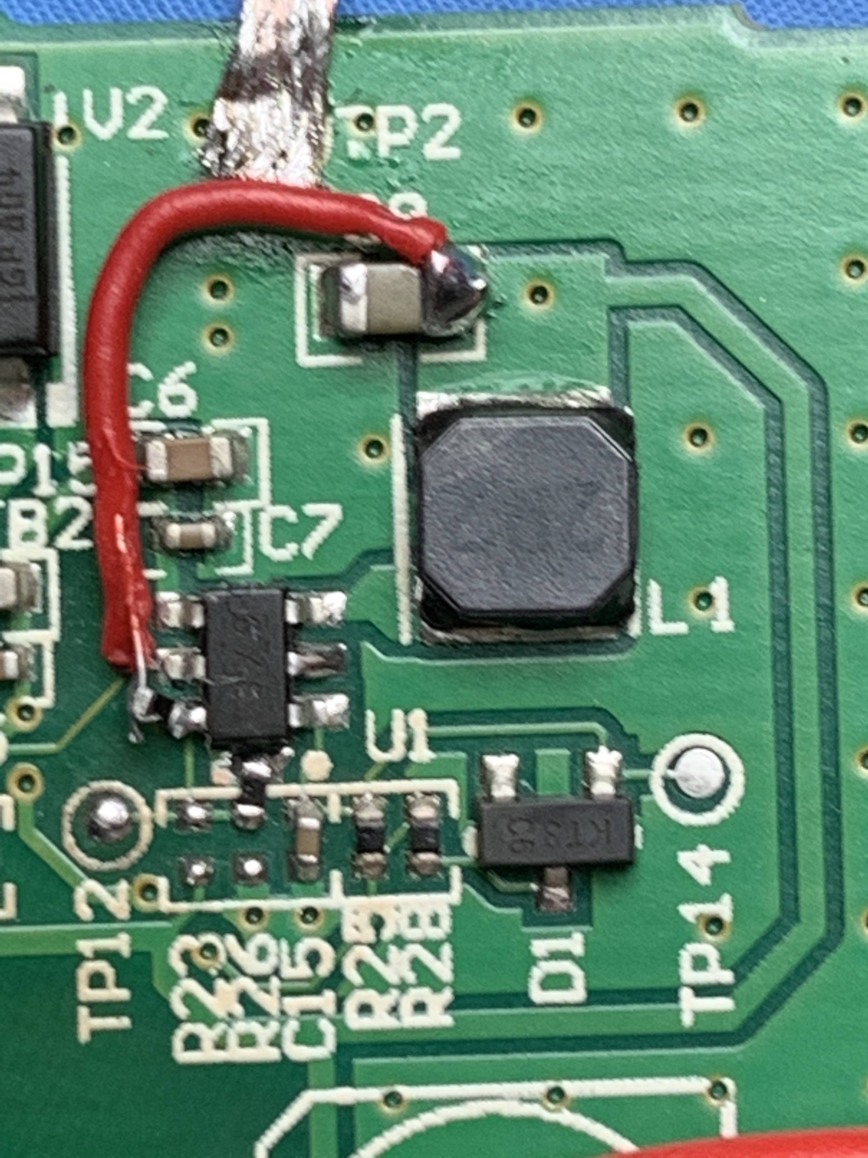

    I have done as you suggested and moved R23 so that I could run a jumper wire directly between this FB resistor and C8.  Unfortunately, the output waveform still looks the same.
    I have also tried turning R26 around so that it connects to GND pin 2 of TLV62568 on the Top layer copper, again no difference was noted.
    Here is a photo of the circuit with the 2 modifications.
  • Hi Steven,
    Can you provide the following waveforms?
    1. Vout and VFB (50ms/div)
    2. Vout and SW node (a. when Vout = 3.3V; b. when Vout = 3.7V). Please measure the frequency of SW node each time.

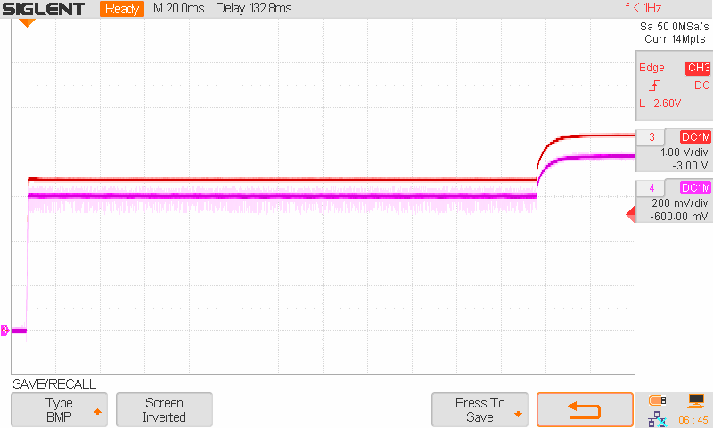

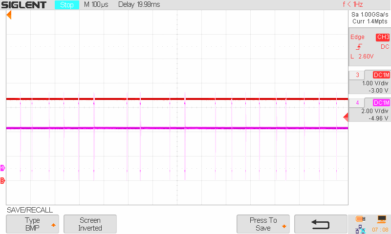

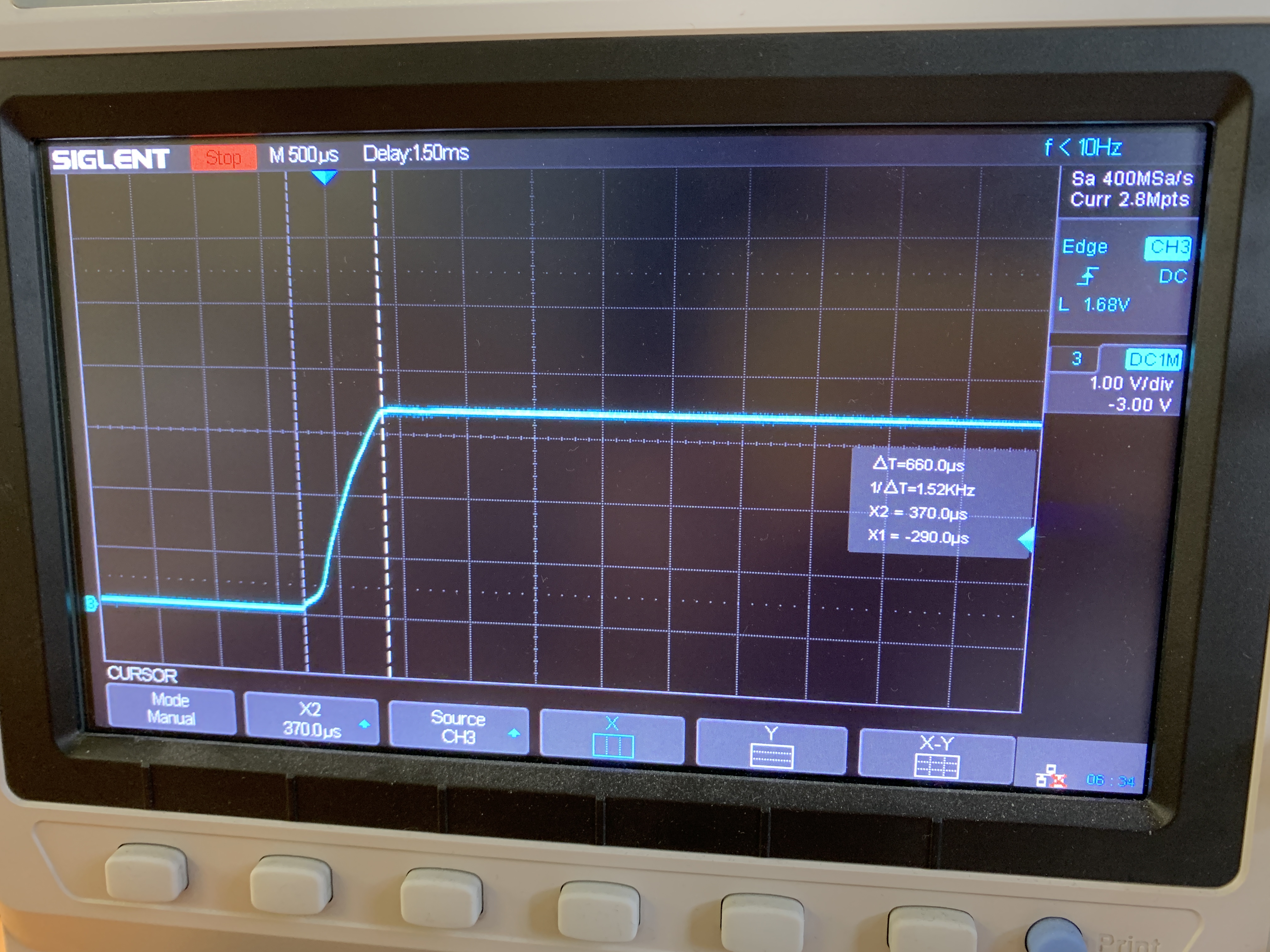

  • Hi Excel,
    The problem is widespread and is not limited to a single device.  I replaced the TLV62568 with a brand new one (from a Digikey packet) this morning and it immediately did the same thing.  The Part marking ix 9X9 which you may have already deciphered from yesterday's photo.
    Here are the waveforms that you requested.
    1: Vout and FB at 50ms and 20ms
    2: SW node switching during at 3.3V
    The Frequency of switching varies considerably as you can see from the below picture (presumably in Power Save Mode)
    2b) SW node, there is no switching when Vout rises above 3.3V
    2c) SW node, at the time the voltage rises from 3.3V

  • Hi Steven,
    I highly appreciate your effort for providing the necessary data.
    I'm pretty sure the +3.3V output node is injected by a higher voltage from an external source which possibly came from CC3220 circuit. Because FB pin will not allow to exceed its regulation voltage unless it came from an external supply on the output.
    As shown in the waveform, the SW node stops switching after ~220ms because the FB is >0.6V which means that the buck converter circuit is not delivering current to +3.3V for it to sustain its voltage level or even higher.
    To verify my theory, don't apply Vin on TLV62568. Apply the supply on CC3220 then measure the voltage on +3.3V. I will not be surprise that the output voltage level is same (>3.3V) as what you are seeing now. If this is true then the issue is not due to TLV62568 but from an external source.
