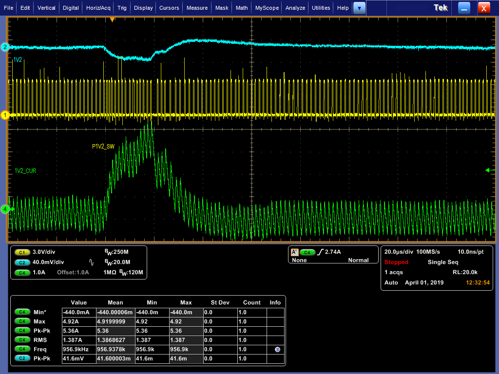

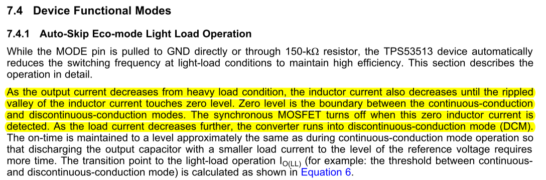

During Our testing we are seeing maximum negative current of around -1A, But as per datasheet,when we running in auto-skip mode, the negative currents are not possible(i.e Lower MOSFET willl be OFF as negative current is sensed).
After probing more, what we understood is most negative current is coming after current transient during settling. Captures are attached for reference.

    Can you zoom in and show both the SW node and the negative current limit? Please show 3 to 4 switching cycles.

    This is for L=1uH & Cfeed = 470pF

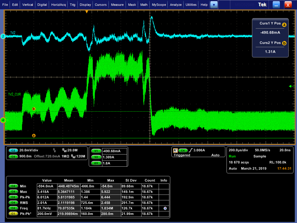

    Below is one more capture, I can see during transient ON time is kept constant and OFF time got varied.
  • Malli,
    How many boards exhibit this behavior? Clearly it is operating in FCCM mode. The SW node waveform has a distinct characteristic in DCM, which I do not see. If this is only one device, possibly it is damaged.

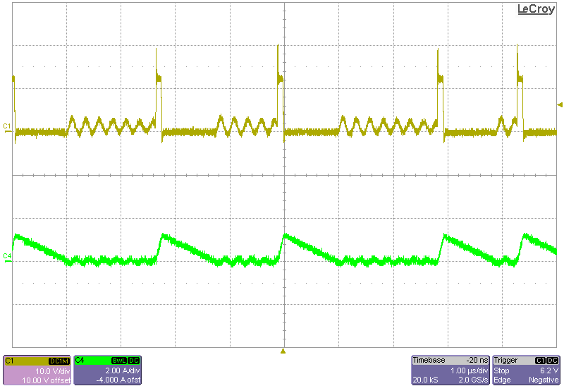

    I have tested an EVM in the lab.  CH 1 = SW node, CH 4 = inductor current. Below waveform shows 250 mA load with MODE connected to GND to select SKIP mode.  You can clearly see the characteristic DCM waveform of SW when the inductor current falls to 0.

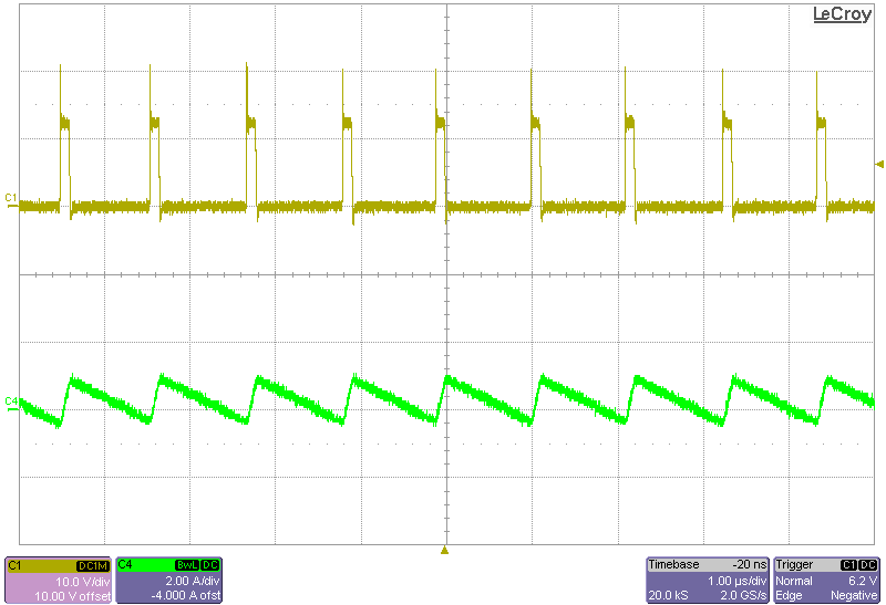

    Next see MODE pulled up to VREG to select FCCM.  Iout is still 250 mA.  Classic FCCM waveforms like yours are shown, with inductor current going negative.
    Conclusion: You are operating in FCCM mode, not SKIP mode.

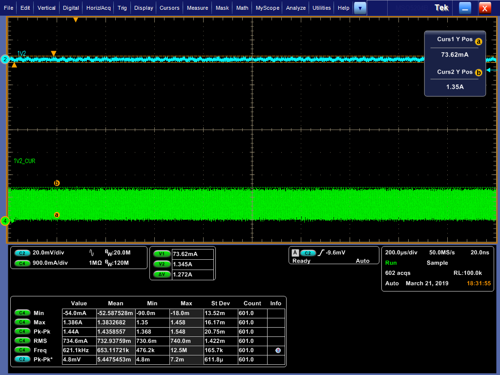

    The green trace is SW node (inductor current) and it is offset by 1 A, correct? It would be easier to get an accurate measurement if you set the offset to 0 A. It looks like you are right on the edge of DCM operation. If you decrease the load more you should start to see the characteristic DCM current and voltage waveforms as shown in my previous post.

    Things i confirmed is TPS53513 is configured for Auto-skip mode.
    With Inductance increased to 1.2uH and with feedforward capacitor of 1.5nF - I can see most negative current is reduced to -160mA.
    It was tested in multiple boards, I am not seeing whatever standard Auto-skip mode characteristics on Switch node waveform(as shown in EVB).
    Can you confirm whether in Auto-Skip mode, is there any possibility that negative current (flowing inwards to Synchronous mosfet) flow?
    What is the impact of this negative current on design, power dissipation or reliability/life time of the chip etc.

    TPS53513 is designed to operate in FCCM mode. In FCCM, there will be negative switch current when Iout is less than ILp-p/2. There is no risk for it. There is a negative current limit, see the datasheet. You should design so that ILp-p/2 is les than that so you do not hit the current limit in no load condition.
