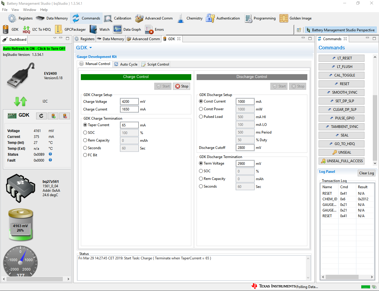

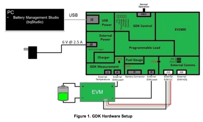

due to the requirement of my current research, I have to use BQ27z561EVM battery gauge and BQ27GDK000EVM kit together to validate some battery models. I follow "Quickstart Guide for Gauge Development Kit" (http://www.ti.com/lit/ml/sluub24/sluub24.pdf) to connect these two instruments as the figure in sluub24.pdf:

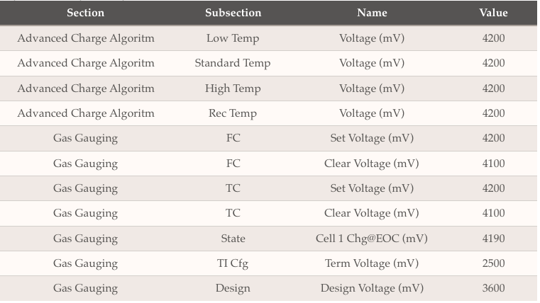

The system is calibrated following the guides of current and voltage calibration. Now I meet a problem that during charging procedure, I set charge current as C/2 (1600 mAh), while the real charge current is only round 780 mA . Anyone could help me about that? I am newbie in this field, if any other information is needed for solving this problem, just let me know. I will update.
