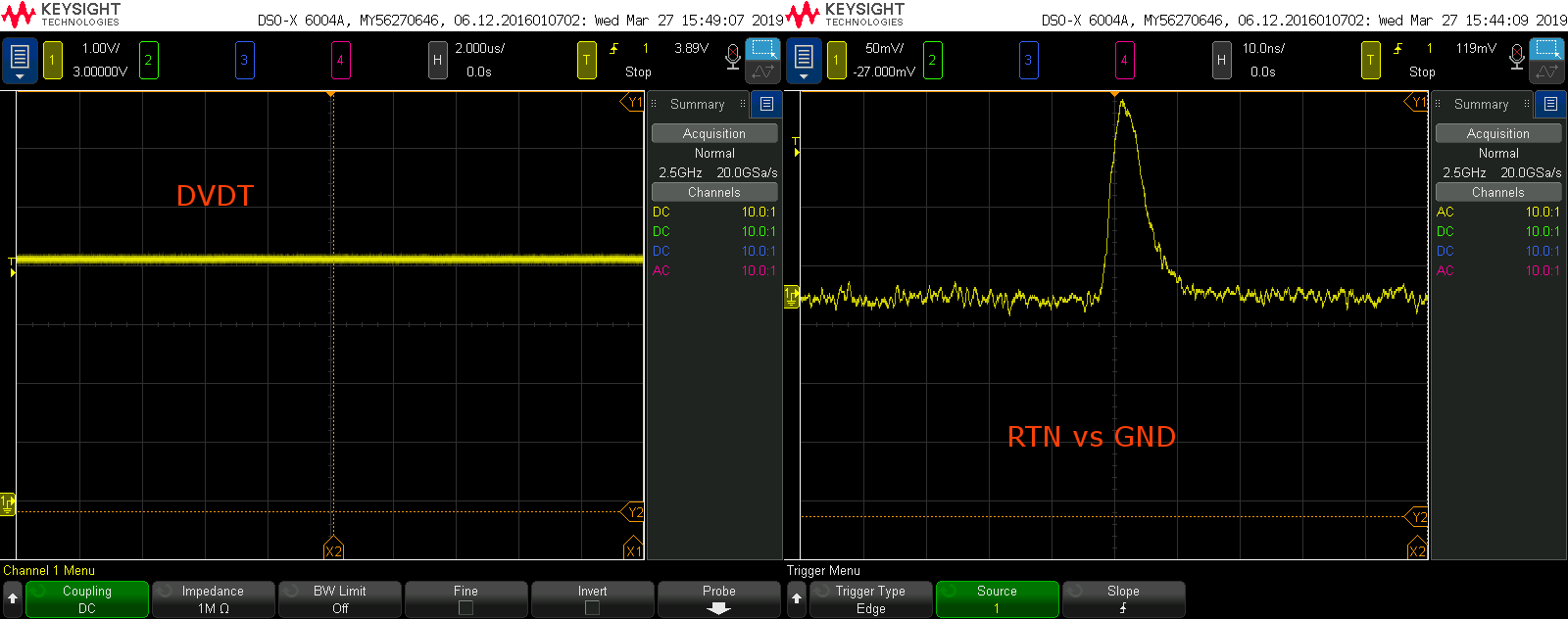

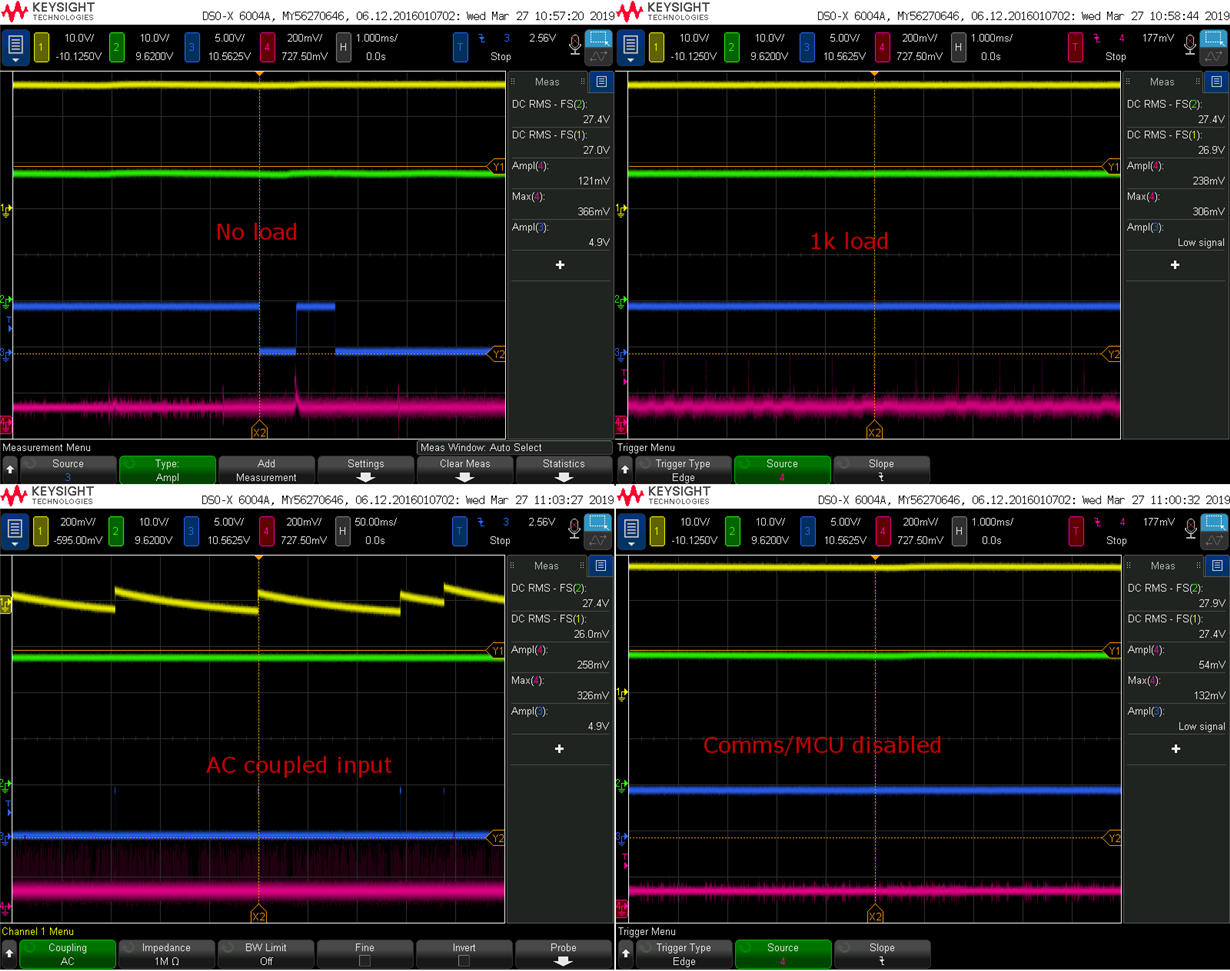

    Attaching some scope plots and schematic snippet. This device is used 3 different places on the board, with slightly different current limits (0.35A to 1.2A), and they all behave in a similar way.
    • Channel 1: DC input
    • Channel 2: DC output
    • Channel 3: Fault signal
    • Channel 4: IMON

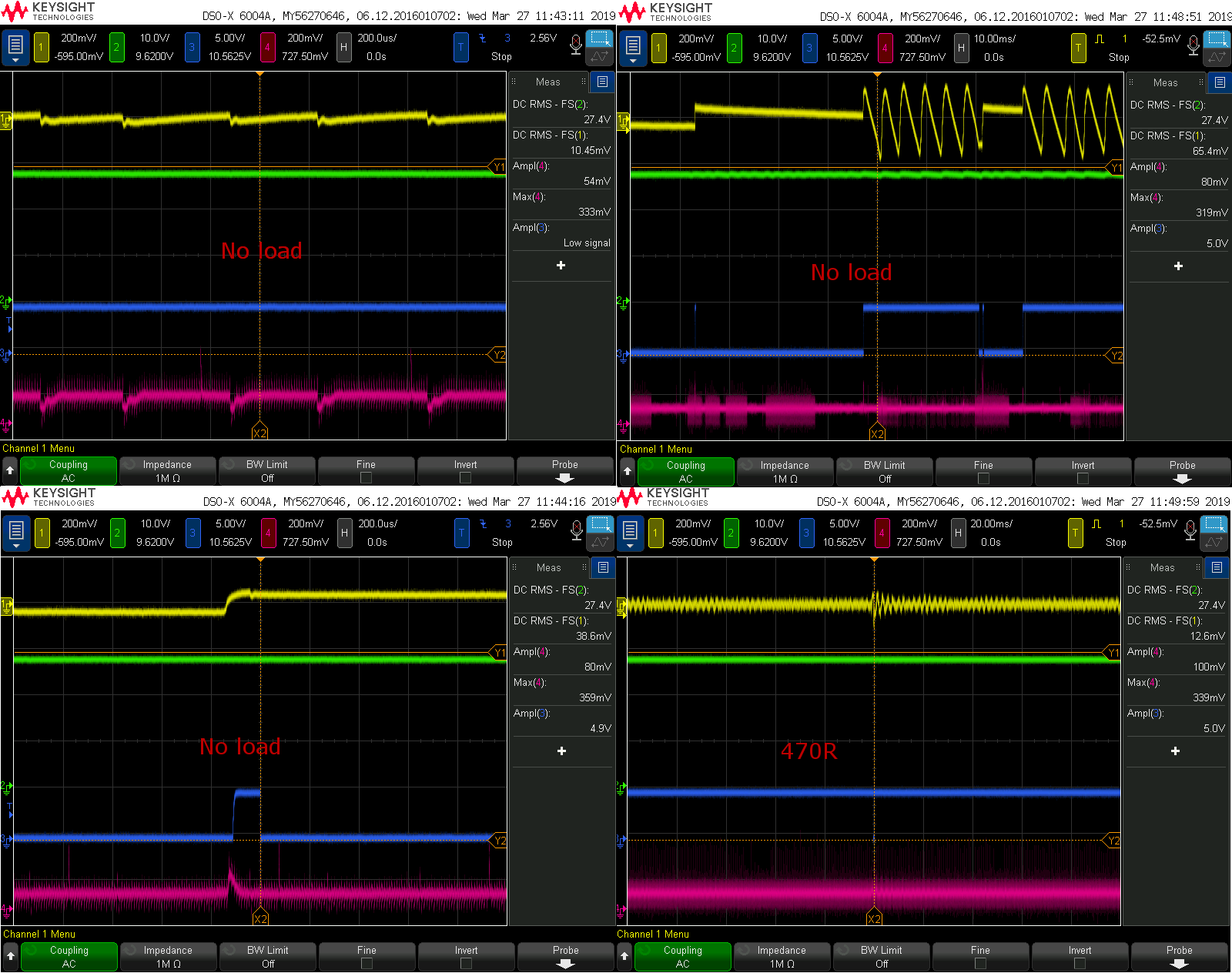

    One observation. In the 3rd plot (AC coupled) it seems the fault signal is triggered with the positive edge (~100mV) of the input ripple(?)
    Various plots with AC coupled input, with various things going on:
    Worst case RTN vs GND, and DVDT.
  • Thanks Thomas for providing with scope shots. It appears that FLT pin is triggering with ripple voltage input on IN pins. This could be due to triggering of fast trip comparator on positive transient on IN or due to triggering of Reverse comparator on negative transients.
    Below are few recommendations:
    • Increase the cap C1866 on IN pins to reduce ripple/transients. A small inductor can also be added in series at input to provide filtering of ripple and transients.
    • Increase ILIM by reducing R1855. (if permissible by other design requirements)
    • Reduce output cap C1874 (if permissible by other design requirements)
    Let us know if you have any further queries.
