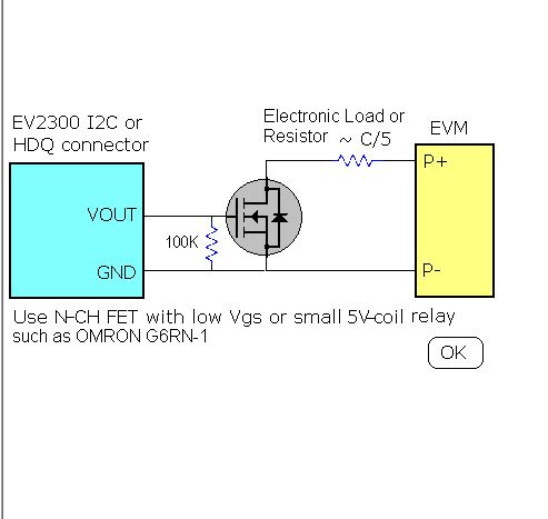

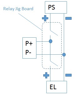

  • Hi
    There is nothing special about the connections. When you click the gpc cycle tab of the tool, it gives you instructions .
    See below picture of the circuit for connection
    thanks
    Onyx

  • hi Luigi,
    The vout of ev2300 is just a low voltage source. I am not certain of it's current sinking capabitlity. There are fets with low vgs that can handle several amps. I would recommend you use one of such with a heat sink instead of the relay. The current sink capabiity of the vout pin of the ev2300 wasn't characterized.
    thanks
    Onyx

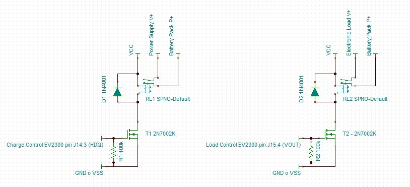

  • Hi Onyx,
    it was you that wrote "Use N_CH FET with low Vgs OR small 5V-coil relay";  I agree with you now that EV2300 or EV2400 can't directly drive a coil relay because of their limited current source capability.
    For this reason I would like to use the following schematic:
    In order to work as aspected this circuit still needs:
    1. Do the EV2300 or EV2400 provide also the power supply for relè coil (VCC)? Or shall I use a separated Power Supply to provide the 5V needed by the relè coil?
    2. What kind of contact arrangement is requested to have by relè in order to correctly be driven by the EV2300 or EV2400 output signals? Form 1A - NO or it better to use Form 1B-NC or even better Form 1C?
    3. In order to manage up to 10A of charge/discharge I think it's more effective to use relè instead of MOSFETs (that remain a viable solution for charge/discharge current of less Amps).
    Please provide all your suggestions for the proposed circuit.
  • 1. No use a separate power supply.
    2. I would suggest that you use a high side similar to "1C", this will have uniform ground if the relays are high-side.
    3. Correct, make sure relays are low resistance (10 mOhms or below).
