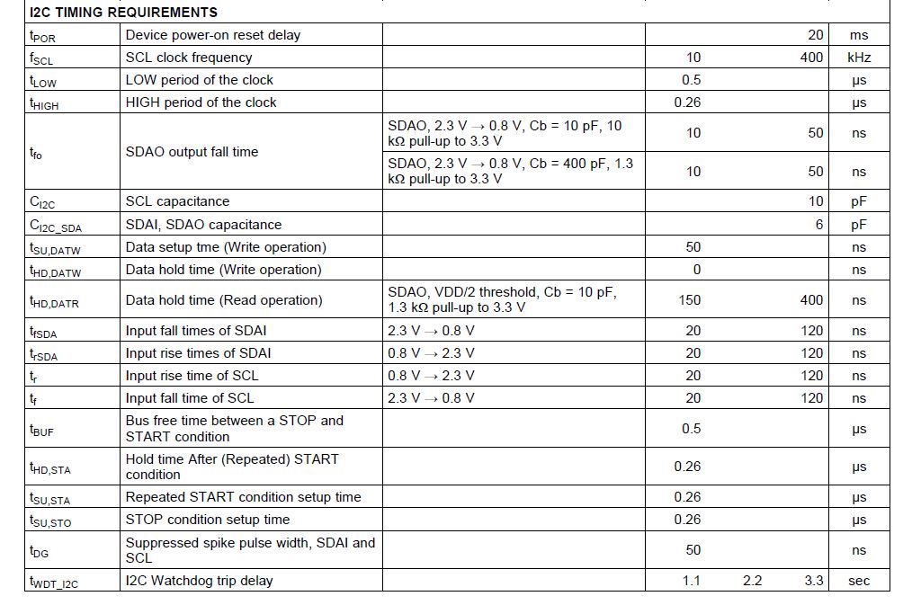

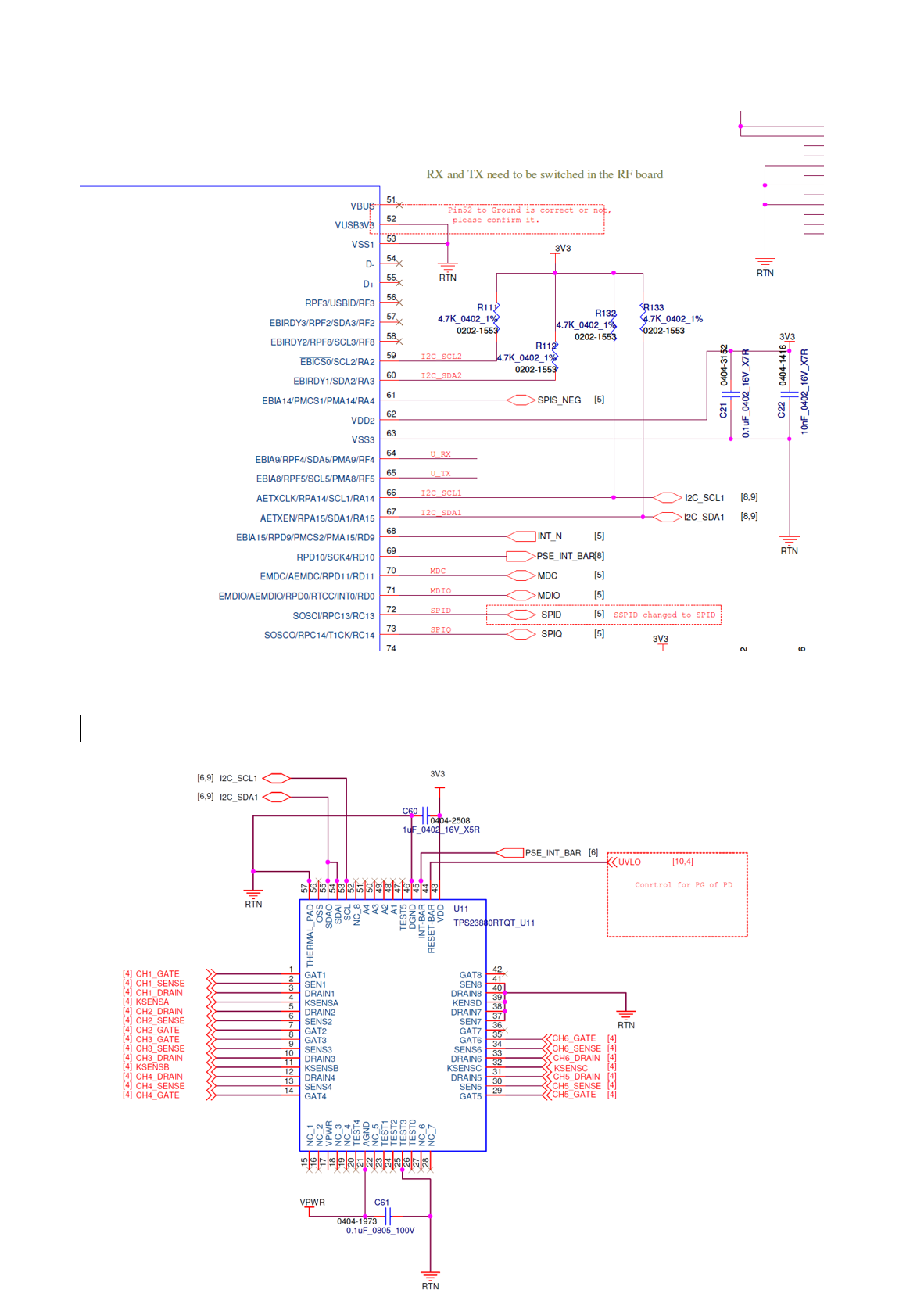

    Can you send me your schematic for review and a waveform(including SCL and SDA) when you don't get an ACK? What's your I2C clock frequency? Have you tried to reduce the frequency?  Can you also take some measurement and make sure the I2C timing requirements(in datasheet) are met? Thanks.

  • The most relevant part of the schematic is shown below. The I2C lines come from pins 66 (clock) and 67 (i/o). The TPS23880 is the only device on the I2C bus.
    I'm running the clock at 50kHz. I have experimented with both slower and faster clock rates with minor differences in the occurrence of my problem. Note that I also started programming the SRAM in 32 byte blocks rather than one byte at a time. This improved the odds that it would program correctly, but still fails about 1 out of 3 or 4 tries.
