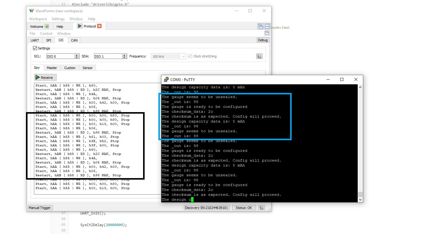

Dear Forum,
I am using a BQ27441 G1B, I have connected it to a microcontroller board (Tiva TM4C123G) using I2C. To initialize the BQ27441 we need to follow 14 steps indicated in the technical reference, sec - 3.1, pg 14, but, I'm still having trouble making these steps work. In step 8, I indicated the value of design capacity that we should expect for type G1B, but not for type G1A. In the code, we set this value to 0xAC to force the if operation, but during the code the read values do not match the one shown in the reference manual and so I can not read the main battery characteristics.

void bq27441_init()
    uint8_t flag_out[10], block_data_checksum_data[10], data[100], design_capacity_data[10];
    uint16_t design_capacity;
    float voltage = 0.0, remaining_batt_cap = 0.0, full_charge_cap = 0.0, soc = 0.0, temp = 0.0, current = 0.0;
    InitI2C0();
    char writeData[3] = {0x00, 0x04, 0x81};
    char unseal_data[4] = {0x00, 0x00, 0x80, 0x81};
    char cfgupdate_data[4] = {0x00, 0x13, 0x00, 0x81};
    char flag_data[2] = {0x06, 0x81};
    char block_data_control[3] = {0x61, 0x00, 0x81};
    char data_block_class[3] = {0x3E, 0x52, 0x81};
    char data_block[3] = {0x3F, 0x00, 0x81};
    char block_data_checksum[2] = {0x60, 0x81};
    char design_capacity_loc[2] = { 0x4A,/*  0x4B,*/ 0x81};
    char soft_reset[4] = {0x00, 0x42, 0x00, 0x81};
    char seal_data[3] = {0x00, 0x20, 0x00, 0x81};
    //Step 1
    I2CSendString(BQ27441_ADDR, unseal_data);
    SysCtlDelay(133333);
    UARTprintf("The gauge seems to be unsealed. \n");
    //Step 2
    I2CSendString(BQ27441_ADDR, cfgupdate_data);
    //Step 3
    flag_out[0] = I2CReceive(BQ27441_ADDR, flag_data[0]);
    UARTprintf("The _out is: %x \n", flag_out[0]);
    if (CHECK_BIT(flag_out[0], 4)) {
        UARTprintf("The gauge is ready to be configured \n");
        //Step 4
        I2CSendString(BQ27441_ADDR, block_data_control);
        //Step 5
        I2CSendString(BQ27441_ADDR, data_block_class);
        //Step 6
        I2CSendString(BQ27441_ADDR, data_block);
       //Step 7
        block_data_checksum_data[0] = I2CReceive(BQ27441_ADDR, block_data_checksum[0]);
        UARTprintf("The checksum_data: %x \n", block_data_checksum_data[0]);
        if (block_data_checksum_data[0] == 0xAC) {
            UARTprintf("The checksum is as expected. Config will proceed. \n");
            //Step 8
            design_capacity_data[0] = I2CReceive(BQ27441_ADDR, design_capacity_loc[0]);
            UARTprintf("The design capacity data is: %d mAh \n", design_capacity_data[0]);
            design_capacity = design_capacity_data[0]*16*16 + design_capacity_data[1]; //two values?
            UARTprintf("The current design capacity is: %d mAh \n", design_capacity);
